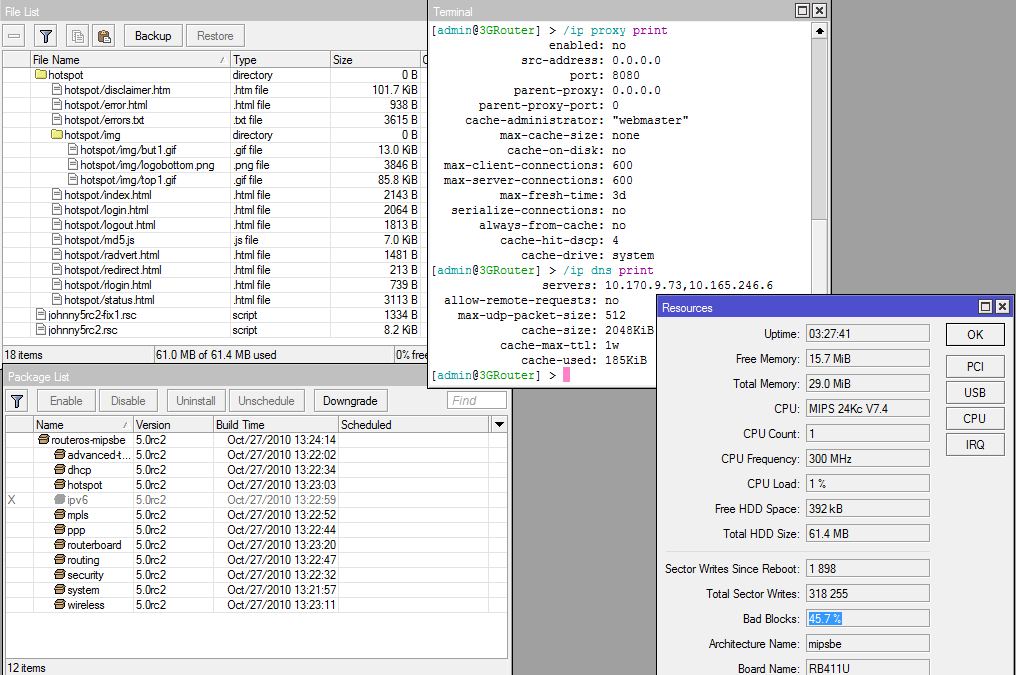

I’m using RB411 as a hotspot in very old Version (5.0rc2)- , and now I can’t upgrade him because they don’t have HDD space.
I want to be able to to this using the DUDE.
I have something like 50 Router all over and I don’t want to go to each of them…
I know that I have too many bad blocks - maybe I config something wrong and because of it I have so many of them?
I’m attaching a pictures of my router
please have a look and try to help me,

The only way to recover this device, is to use Netinstall and reinstall RouterOS. It will also recover the bad block:

I see , this is my problem -

what cause bad block -and how can I avoid it?
There was a bug in previous RouterOS version which could cause bad blocks to appear on certain model of NAND chip. It is fixed. You have to use Netinstall to reinstall to v5.18 (will be released shortly)
