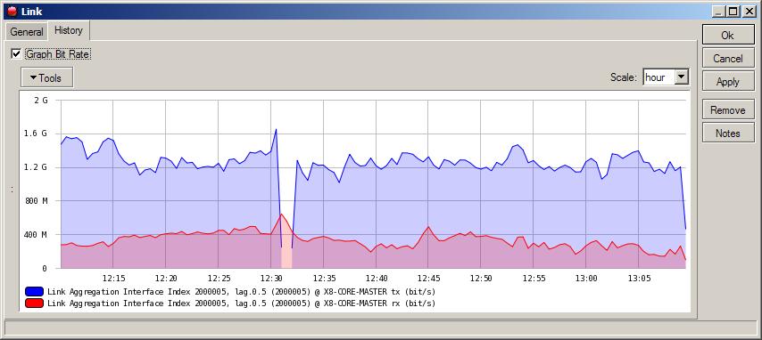

No graph above 1,6Gbps
As you can see on the next picture, I have some links with throughput above 1,6Gbps.
On the link label I can see the correct value but in the graph something is wrong.
is it a bug?
With 30 second intervals you can record a maximum of about 1.5 gigabits/second while using 32 bit counters, I’d imagine that gap is right when the counter rolled over.
You could cut your polling interval in half to double the value you could graph. I have not seen it yet but I am sure I will some day. Our 10GB link between sites runs close to 1.5Gb.

  • the interval you talk about is the “probe interval”, ok? I have modified it to 20 seconds (I had this value in the label refresh interval)…
  • I’m using SNMPv2, so the counters are 64 bits, not?

I have to say that changing the probe interval to 20 seconds doesn’t work
I was afraid that would happen, Just goes to show there is still more to learn.
SNMP v2 does not automatically give you 64 bit counters an as far as I can tell there is no way to get the dude to use 64bit counters with out building a custom probe… yuk. I have not seen a way to add a predefined link type that relies on the 64bit counters.
To take a guess at what is going on with the links, maybe they are forced to 30 seconds and ignore the probe interval.
As I said I currently don’t have any counters rolling over so I don’t have a good testbed for your trouble. And now I don’t know what to try since it seems that the probe interval for links is not tied to the global probe interval.
For your 10Gb links did you create a custom link type and specify the maximum 32 bit number? “4294967295”.
You will notice it will not allow you to place a higher number in the link.
