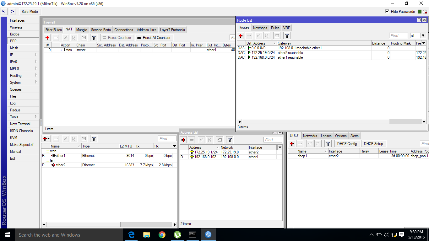

I have read the basic configuration wiki , following which I configured my x86 routerOS as the following:
ether1 : wan
192.168.0.102/24
ether2 : lan
172.25.19.1/24
setup default srcnat
and ran a DHCP server on ether2
but now I can ping 8.8.8.8 from ether1 but not from ether2
why my srcnat not working?
I have attached a screenshot of these configs
On command prompt on your pc run “ipconfig /all” and come back with network settings.
src-nat is working as packets are Firewall Filters. If needed, disable all drop rule and test again. You should find where the problem is.
I assume you can ping the internet from the router itself?
Can you ping 192.168.0.1 from lan?
What happens if you do a traceroute?
It could be the dhcp address on ether 1 causing you troubles.
Turn off dhcp client and then assign 192.168.0.102/24 to that interface
