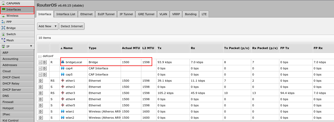

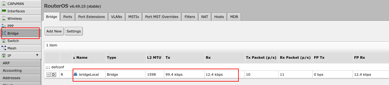

Thanks, I suspect this too. But where to set GW for Bridge? See pics attached.

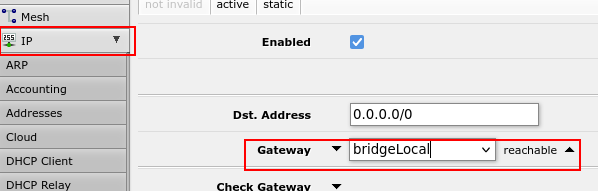

Set your main router’s IP address in Gateway field.
When I try to set GW like this Mikrotik show it red and become unreachable.
Basic problem of your WiFi AP is incomplete IP address setting, it’s missing subnet setting. Change it like this:
add address=192.168.11.251> /24 > interface=bridgeLocal network=192.168.11.0
After you fix IP address, you’ll be able to enter router’s IP address which is currently rejected.
