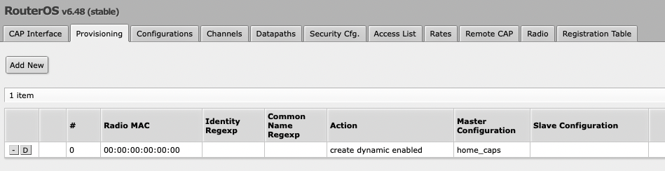

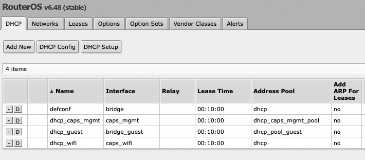

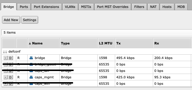

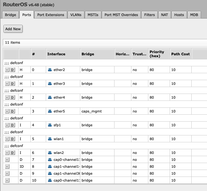

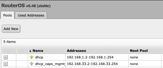

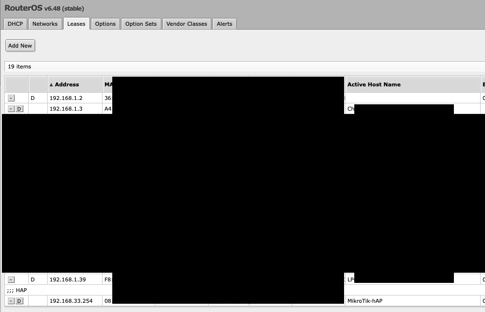

Problem:
The whole mesh network works just fine. All devices are connected seamlessly, and as desired, are connected to the same subnetwork 192.168.1.x.
But if I try to connect PC through LAN port on slave device, it won’t get access to the internet (it gets ip from 192.168.33.x poll).
What should I change in my configuration to be able to use lan ports on slave CAP.
Screenshots of configuration should be available in attachments.
Please let me know if there is some more info required.
