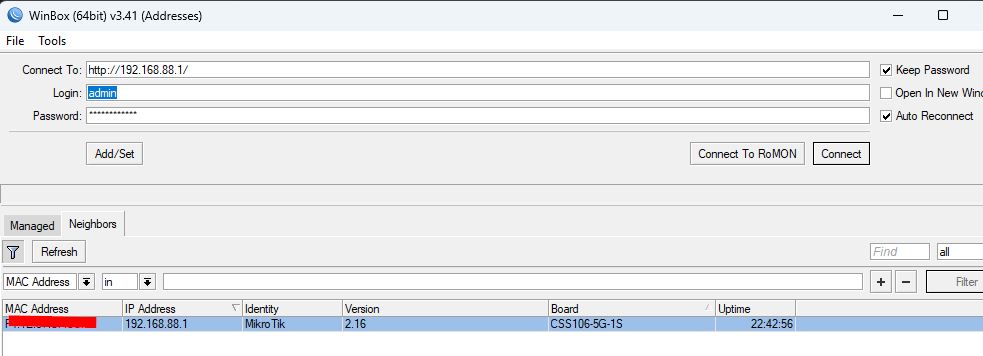

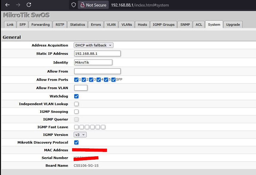

By the fact that when you connect the laptop directly to CAP 2 everything works, but through RB260 does not work, you can understand that the problem lies in its settings. Show / see the settings of RB260, unfortunately it is SWOS and you can only show screenshots of settings. First of all check what IP address it has, you can see in winbox/neighbors
Here it is:
You have a conflict of IP addresses. change the rb260 address to any free one.
192.168.88.1 is the same address on the router.
I have changed the IP address of rb260gs to 192.168.88.246. Is this ok?
