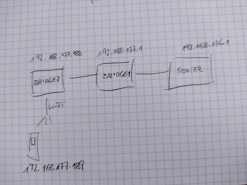

I cannot access internet from my Wlan devices on Bridge2.
Setup is a follows:
(Bridge1 and Bridge2 are MikroTik devices)
From my smartphone 192.168.177.189 I can ping 192.168.177.188, 192.168.177.1 and 192.168.176.1
From 192.168.177.188 and 192.168.177.1 I can ping my smartphone 192.168.177.189.
(192.168.176.1 is the router from the ISP and does not support any tools like Ping)
Ping time is sometimes up to 180ms (which is pretty much from my feeling)
From Bridge2 I can execute a traceroute to e.g. goolge.com successfully.
But I cannot access the internet from my e.g. smartphone connected to the Wifi of Bridge2
Any proposals how to solve this issue are very appreciated!

I have no clue what you mean by MT device and no clue what you mean by bridge.
Which devices (models) and are they acting as switches only, or as switch/ Access Point Switches, or Routers for example.
Are they wired ?
Both are configured as Bridges and connected with a network cable.
From ether2_basement in Bridge1 to ether2 in Bridge2.
ether1_LAN in Bridge1 is connected to the ISP Router.
Bridge1 has RouterBOARD 750G r3.
Bridge2 has RouterBOARD 941-2nD.
Well, again I find that confusing, a bridge is functionality within the device, its either a switch or a router etc.
So I will take it as switches.

On your Bridge1 configuration you have the address 192.168.177.1 set to interface=ether2, this should be set to the Bridge that port salved to, interface=bridge_192.168.177.0.
Also the other IP’s for the other ports also slaved to that bridge will also not work.
…when thinking again, yes, in this basis config it seems to be a switch.
When this is working as expected, config will become more complex and then, at least in my understanding, it has to be a bridge because of multiple IP address segments.
Configuration on bridge1 seems overly complicated to me. From a quick glance nothing is sticking out as wrong to me, but frankly I don’t want to delve into config. There are quite a few mis-configs (which don’t necessarily break the whole config, such as assignment of IP addresses to each of bridge slave ports, but one never knows).
You may want to torch traffic on both sides of bridge1 while pinging IDP modem to verify that packets are properly SRC-NATed.
Thanks for your support, guys! The switch hint was the push into the right direction.
Finally topic “Using MikroTik hAP as simple switch plus wireless AP” http://forum.mikrotik.com/t/using-mikrotik-hap-as-simple-switch-plus-wireless-ap/107237/28 from vecernik87 saved the day.
