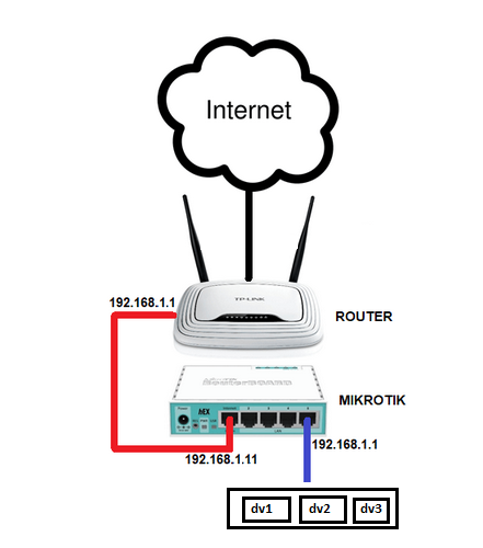

hi guys,
i have mt router rb951 .My network definition is such that a TP-Link router is connected to Mikrotik as a bridge.
There are two problems for me with this config.
1.All connected devices have internet without any problem, but Mikrotik Ping router itself does not have internet
2.I did everything to port forward, but it didn’t work

Using your Mikrotik router, what are you trying to ping?
Why are you using PPOE on the MT when the TPLINK is giving you a fixed private IP address?
First thing is to decide whether you want the MT to be an AP/switch or a full router.
Being behind the TPLINK router means for any port forwarding scenarios you will have to contend with double nat
On blu line on picture, is present again 192.168.1.1…
You have assigned 192.168.1.1 both to the mikrotik and the tplink?

thanks ,This problem was solved with your help
Thank you very much, dear
