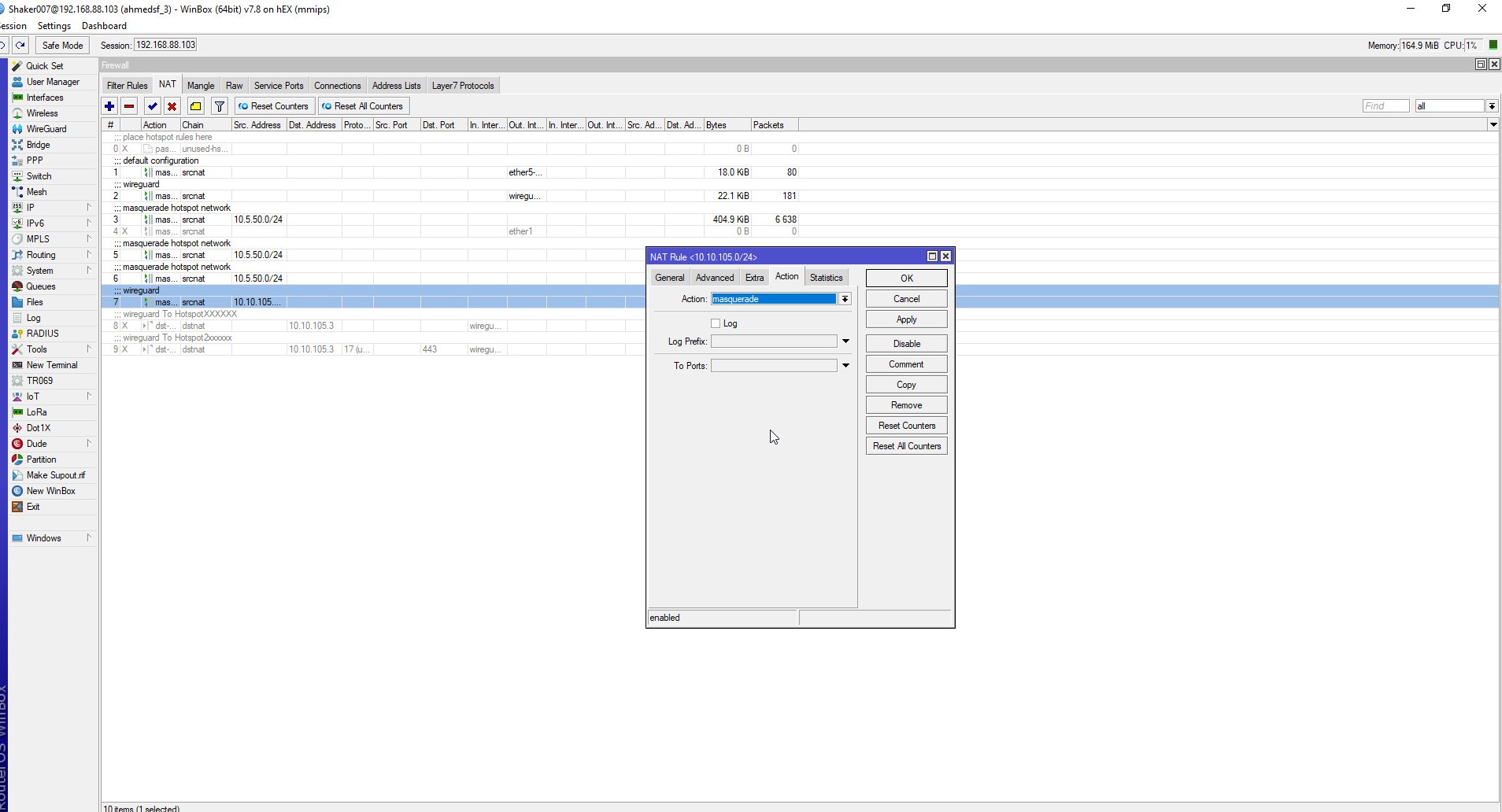

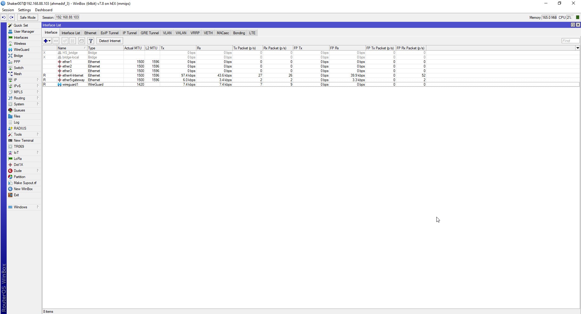

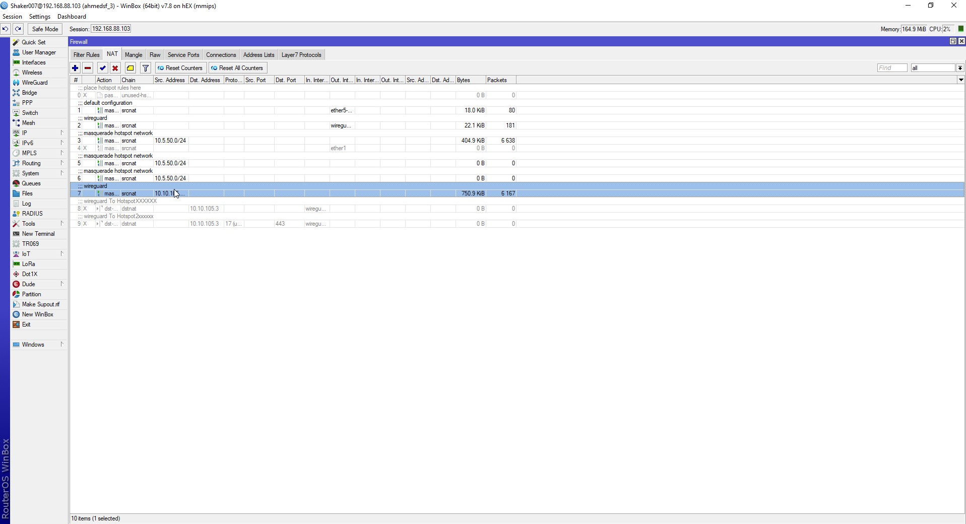

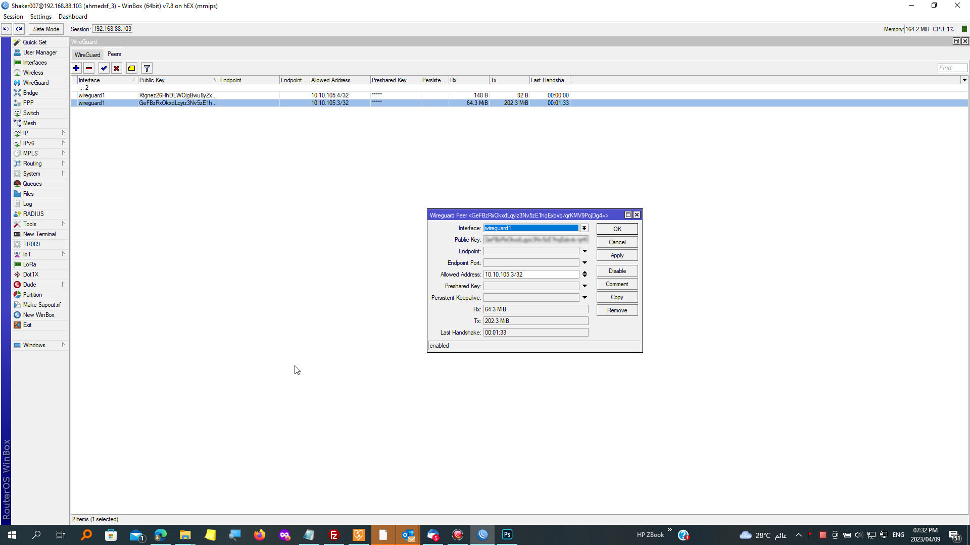

this is some screenshot
If you mean any other information, please explain what I do
and this a config of Wireguard

No need to sourcenat your wireguard traffic in this case… but will wait for config to see.

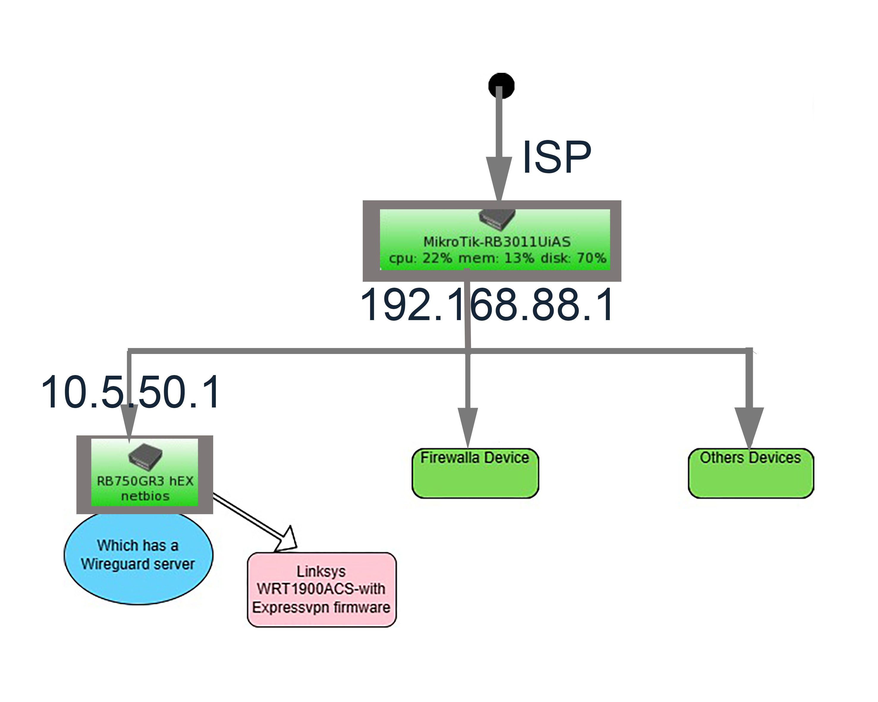

Supplement according to what I understood from the topic network diagram
and export config file
