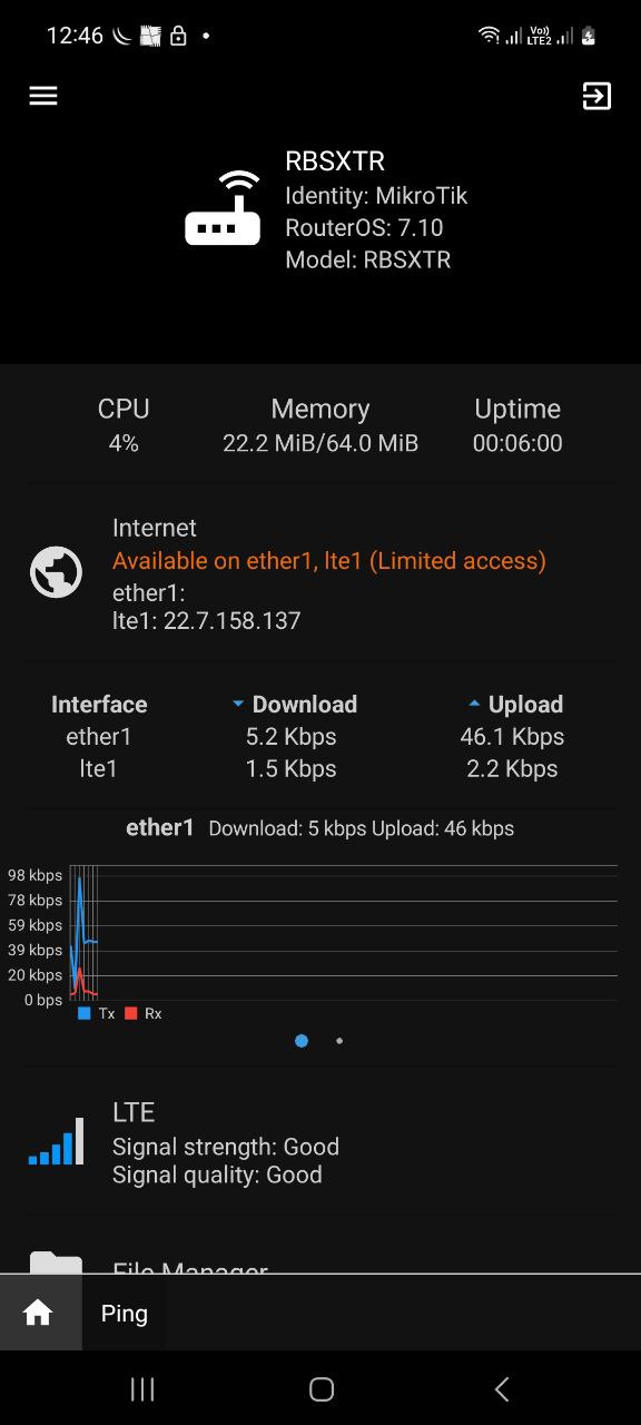

I have a RBSXTR and it worked fine for almost 2 years until the internet went down a few days ago. I have checked almost everything. I tested SIM cards of different operators in different slots, everything seems to be working both in terms of hardware and software. I also upgraded the firmware to 7.10, but my problem is still not solved and I have no internet.

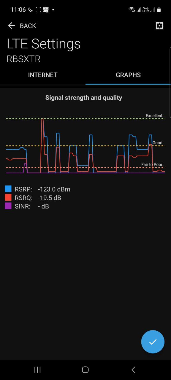

Why is my signal fluctuating so much? Is the problem with module R11e-LTE? Could this module be damaged? (I can receive SMS)
How can I recognize that this module (R11e-LTE) is damaged and needs to be replaced?

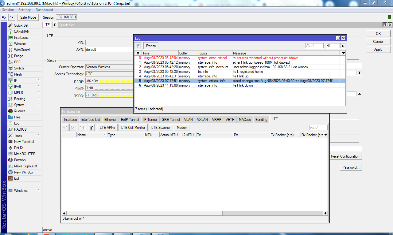

Why does the “lte” interface come and go? What is this jump for?
Why does it sometimes exist and sometimes disappear?

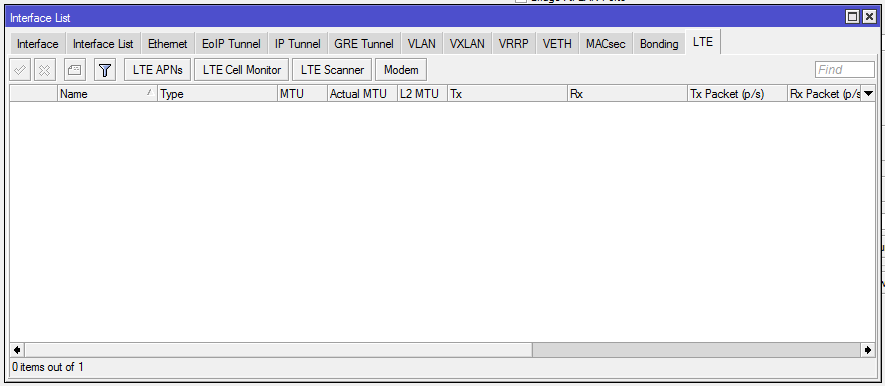

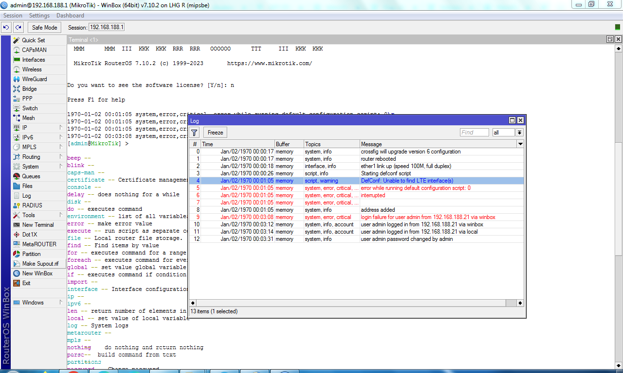

what does it mean? Why LTE Interface is missing?
I think “disappearing LTE interface” is a recently introduced bug. It probably was not a good idea to upgrade, but now you may try to upgrade to testing version (7.11rc2)

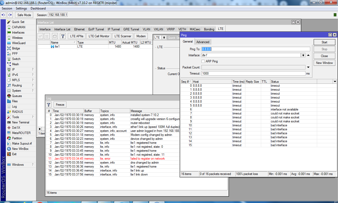

Why LTE1: not registered?

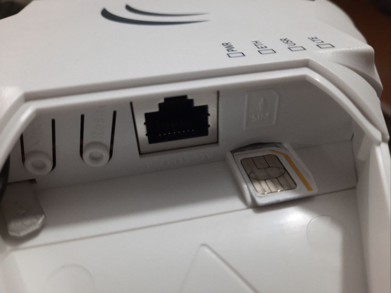

The modem is fixed in one place and the SIM card is inside it and no one has touched it !!!
Is the direction of the SIM card correct?

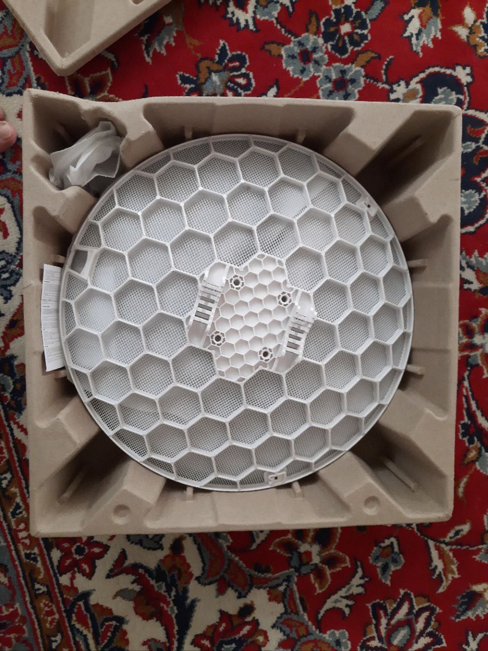

“LHG LTE KIT”
For ease of testing, can I use “LHG LTE KIT” without a dish? If we use it without a dish, it will not work at all? The photos on the site are grayer than my dish. My dish is almost white. I bought this online, did the seller send me the wrong dish?

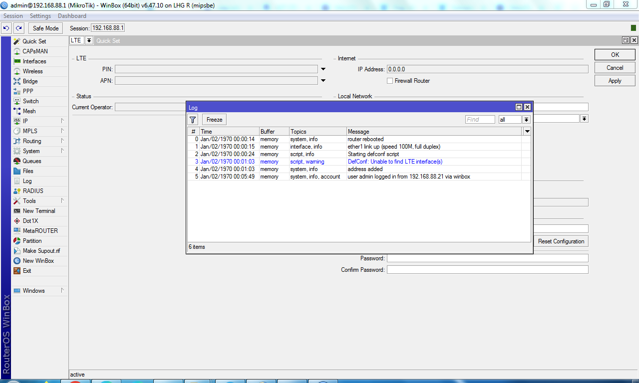

I installed different versions both with Netinstall and in normal mode, but the problem of the LTE interface was not solved.
Is it possible that the SIM card slot is broken? If the SIM card slot is damaged, the LTE interface will not be displayed at all? I have tested many sim cards, sometimes it works randomly.
