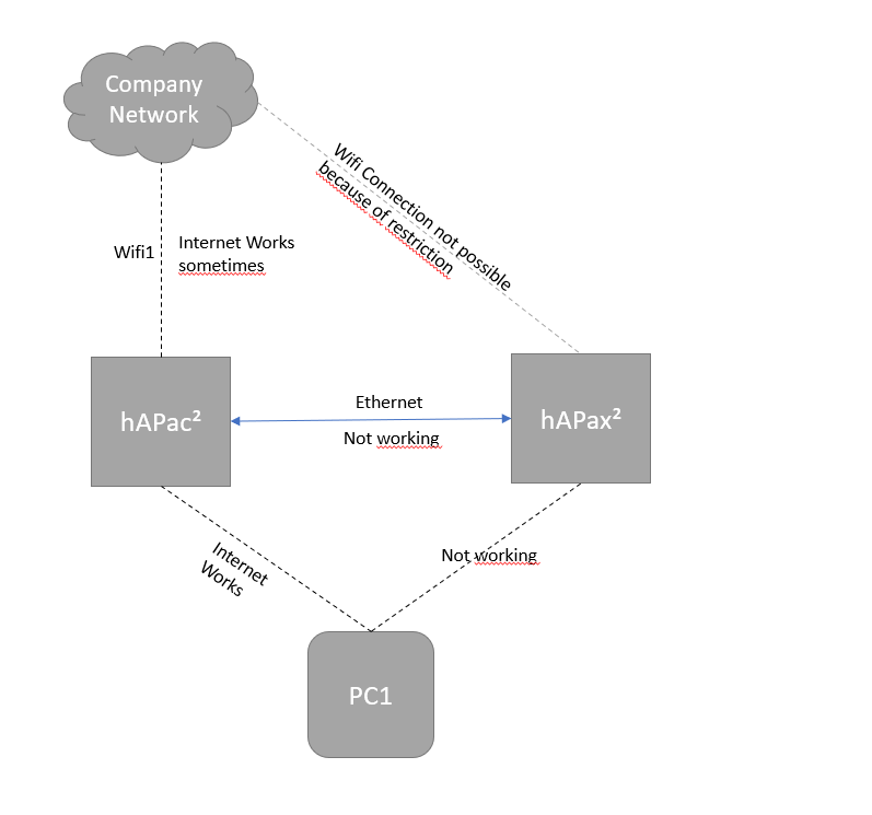

I got a new hapax2-Router. I wanted to have internet access with that. The challange is to connect the new Router(hapax2) to the already used hapac2-Router, which already is connected to a company network where the hapac2 gets the internet access. I added some attachments to understand my problems and my setup better.
The hapax2 is connected via ethernet to hapac2 so I can get access to both routers with winbox. The hapac2 is connected to a company network via wifi. I wanted to have a wireless connection from hapax2 to hapac2 so the hapax2 gets the same internet connection.
I do not even have internet connection over the ethernet. And the worst thing is that sometimes the hapac2 has no internet connection and makes problems if its plugged in via ethernet with hapax2. Normally it never made such problems.
I think there is maybe a dhcp problem here, but I do not know how to solve that problem.

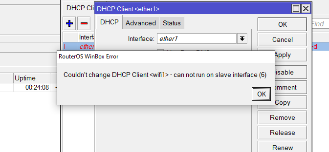

The only possible option I have there is the Home AP Dual as you said but nothing else. On my hapac2 I automatically have very much options under quicksets. How do I change that mode to cpe on hapax2 under quicksets or add the component cpe.
You can’t add “components” to Quick Set mode portfolio. If it’s not there, then you’ll have to do the config manually. It’s not easy task though. Perhaps you can start with Home AP dual, which makes ether1 to be WAN interface. Then the steps are roughly the following:
