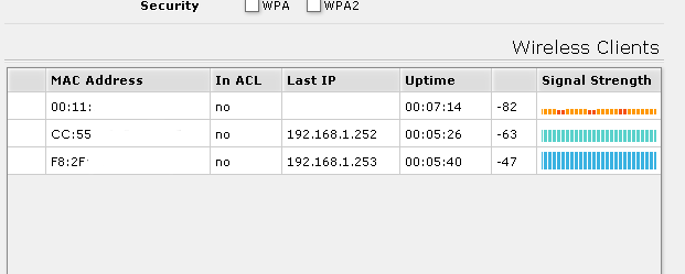

OS 6.11
DHCP is set up… most of devices have no problem obtaining IP..
except nano time logger…
when im adding IP + DNS an the nano device manually im experiencing the same problem
Plz Help !

apm6828
13:44:29 wireless,info WIRELESS: 00:11:XX:XX:XX:XX@wlan1: connected
13:45:29 wireless,info 00:11:XX:XX:XX:XX@wlan1: disconnected, 802.1x authentication timeout
13:45:29 wireless,info WIRELESS: 00:11:XX:XX:XX:XX@wlan1: disconnected, 802.1x authentication timeout
13:45:29 wireless,info wlan1: data from unknown device 00:11:XX:XX:XX:XX, sent deauth
13:45:29 wireless,info WIRELESS: wlan1: data from unknown device 00:11:XX:XX:XX:XX, sent deauth
What type security do you have set on the AP? Looks like your security mode or passphrase in the apm6828 may be incorrect.
