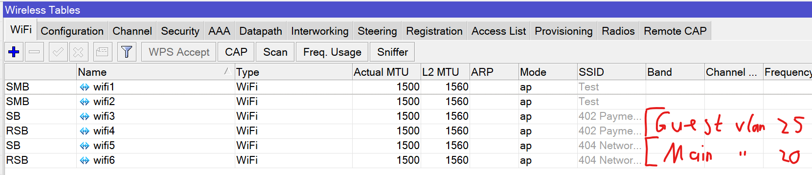

Hello, my WLAN is not working properly and is not assigning any IPs.
For your information:
VLAN 1 = LAN
VLAN 25 = Guest
I have a L009UiGS as router and a cAP ax as AP.
A trunk goes from ether3 on the router to port 1 on the AP.
Port 2 on the AP is the port for VLAN 25, to which guests can connect.
The guest network is distributed via wifi3 and wifi4, wifi 1 and wifi 2 for the LAN network.
WLAN via the guest network also works, you get IPs from the VLAN etc. But wifi via the main LAN network (vlan1) does not work, no address is assigned via DHCP. Why not?
Thank you very much for your help.

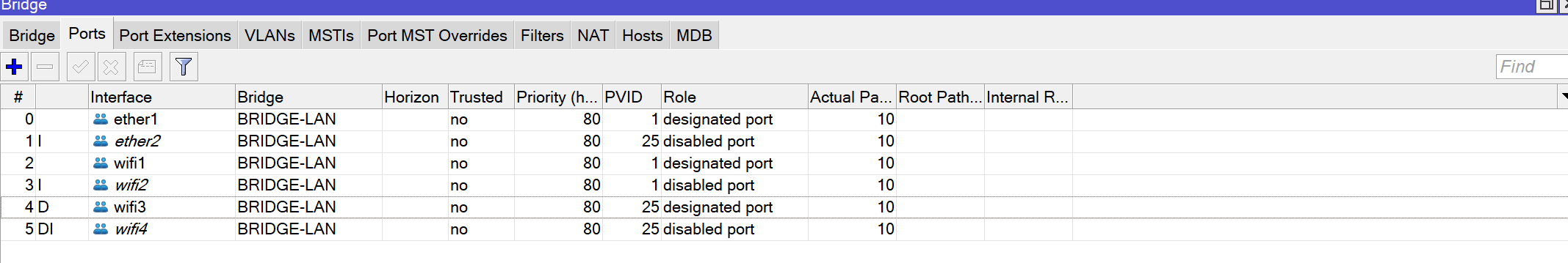

add bridge=BRIDGE-LAN interface=ether1 internal-path-cost=10 \
    path-cost=10
add bridge=BRIDGE-LAN frame-types=\
    admit-only-untagged-and-priority-tagged interface=ether2 \
    internal-path-cost=10 path-cost=10 pvid=25
    admit-only-untagged-and-priority-tagged interface=wifi1 \
    admit-only-untagged-and-priority-tagged interface=wifi2 \

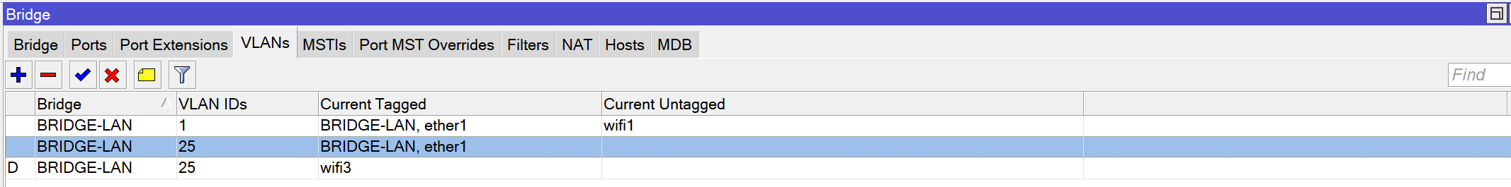

/interface bridge vlan
add bridge=BRIDGE-LAN tagged=BRIDGE-LAN,ether1 untagged=wifi1,wifi2 \
    vlan-ids=1
add bridge=BRIDGE-LAN tagged=BRIDGE-LAN,ether1 vlan-ids=25

And under Bridge Ports it looks like this:
I strongly recommend you to use VLAN ID other than 1 for main LAN. VID 1 is used as implicit default all over so if you don’t configure things very carefully, default config will kick you in the back.
I have now changed this, please find attached the changed config.
DHCP in vlan 25 (guest) still works, but DHCP in vlan 20 (LAN) still does not.
    path-cost=10 pvid=20
add bridge=BRIDGE-LAN interface=wifi1 internal-path-cost=10 \
add bridge=BRIDGE-LAN interface=wifi2 internal-path-cost=10 \
    vlan-ids=20
add bridge=BRIDGE-LAN tagged=BRIDGE-LAN,ether1 untagged=wifi3,wifi4 \
    vlan-ids=25

I’ve managed to do it somehow, but I don’t know why it works like this.
Why does it work like this but not otherwise?
I have created the main wifi (LAN, vlan20) as child wifi and not put it on the main antennas (wifi1 and wifi2).
That’s how it works, for whatever reason.
