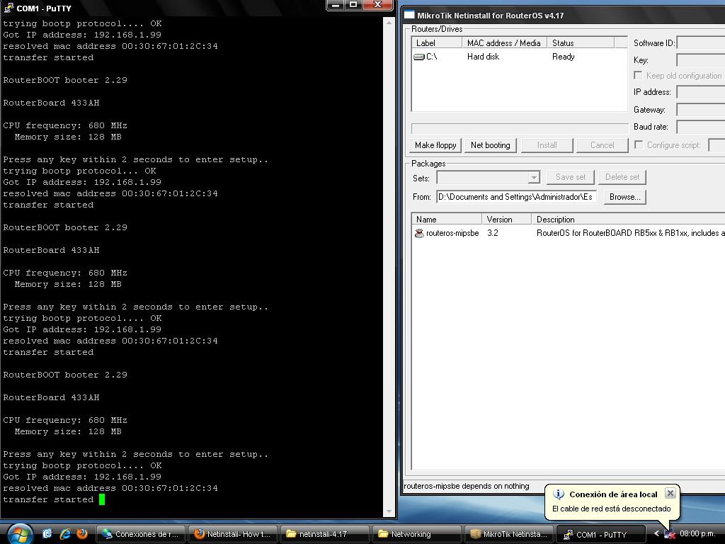

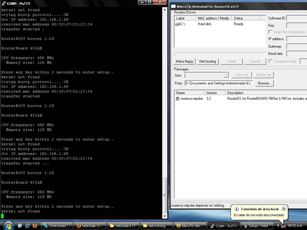

When i turn on the routerboard i can see it on hyperterminal (connected by serial cable), i press any key then it let me to access to the boot menu, then i set it to boot from ethernet, then it reboot and it got the ip from netinstall but it says “Transfer started…” and it just reboot and do nothing else than reboot and reboot without stoping itself, so i can’t never see it on netinstall, never. so how can i install kernel if i can’t see it in netinstall? What can i do? please helpme i’m so frustrated. Thanks for replying and sorry for my bad english. Help Please.
Below 2 captures of the problem.

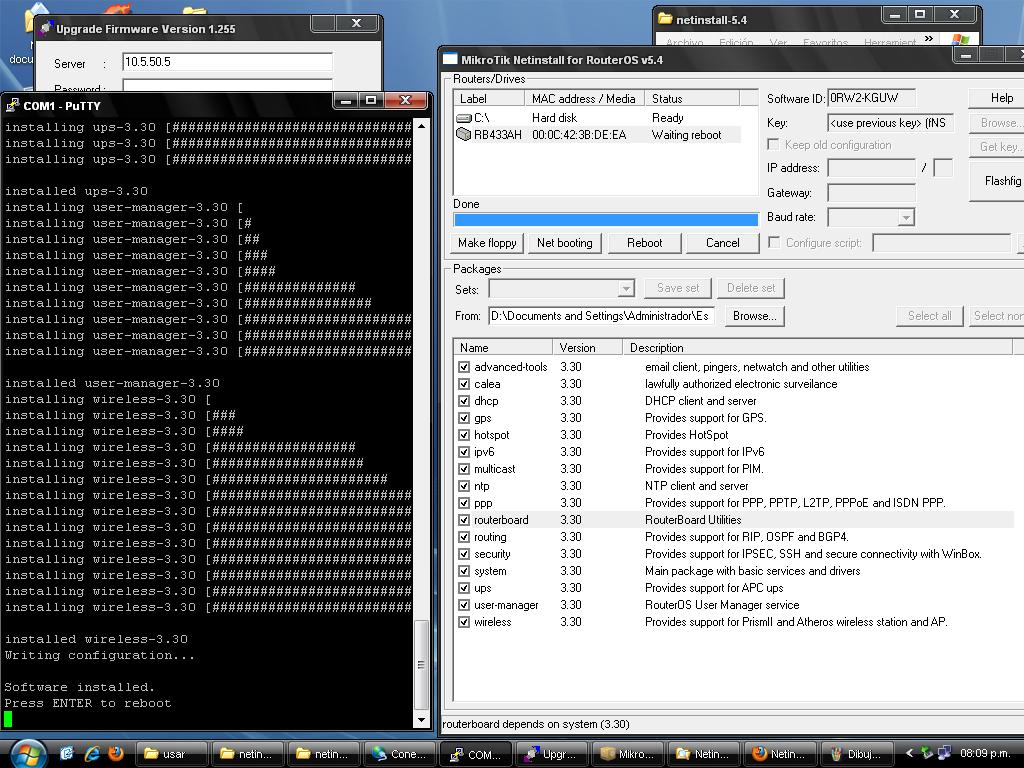

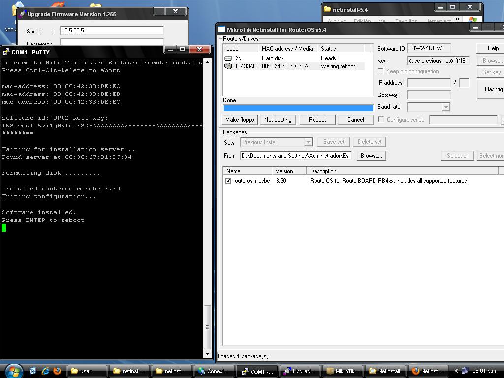

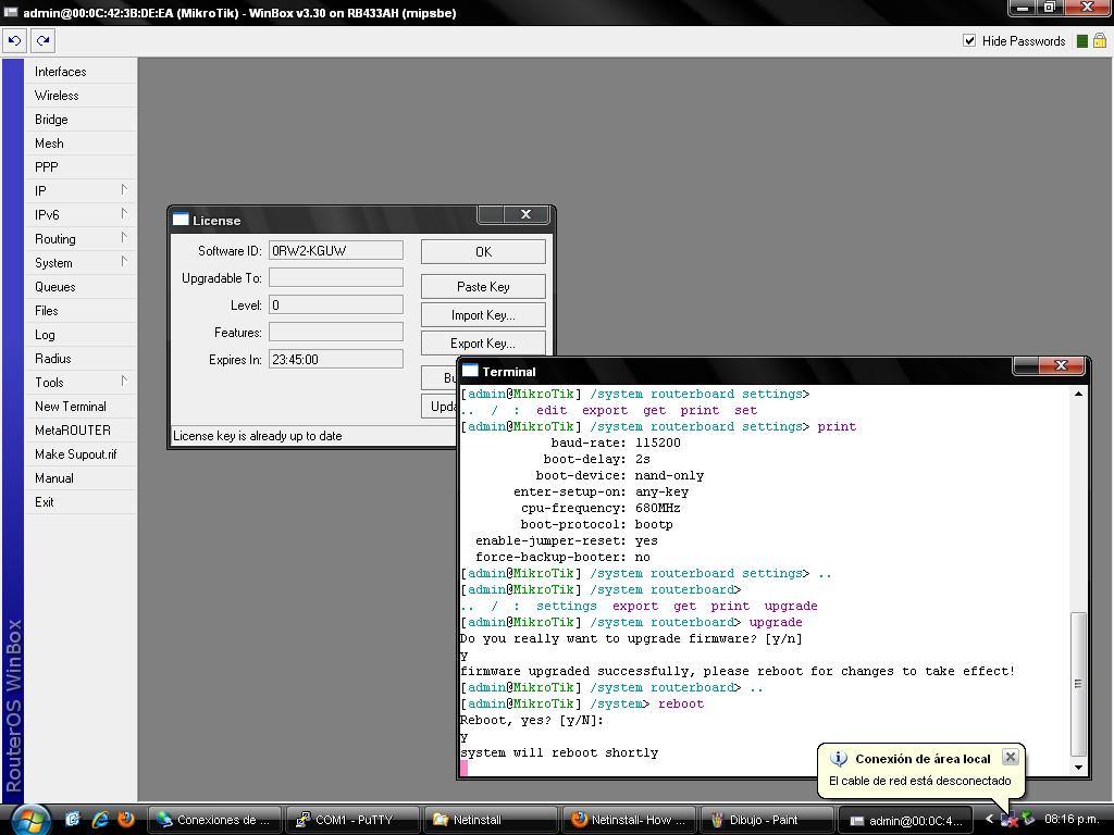

Finally i’ve got running it in netinstall. All i had to do was put the minipci card into the Routerboard then it letme install the kernell by netinstall(dunno why). But now i have a new Software ID and the routerboard has not a License key, What can i do? (all beacuse i’ve formated the NAND) Can someone help please? Do i have to pay for another License Key?
Here some captures…
write to support@mikrotik.com; they will provide you with another license key - if you state your problem, you should get it without charge.
Thanks, everything is done, now my routerboard in on the go! :sunglasses:
