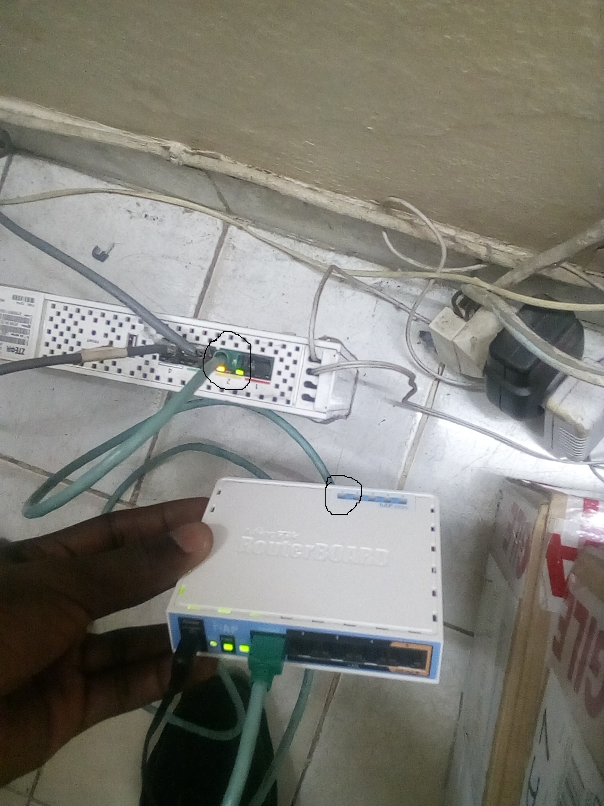

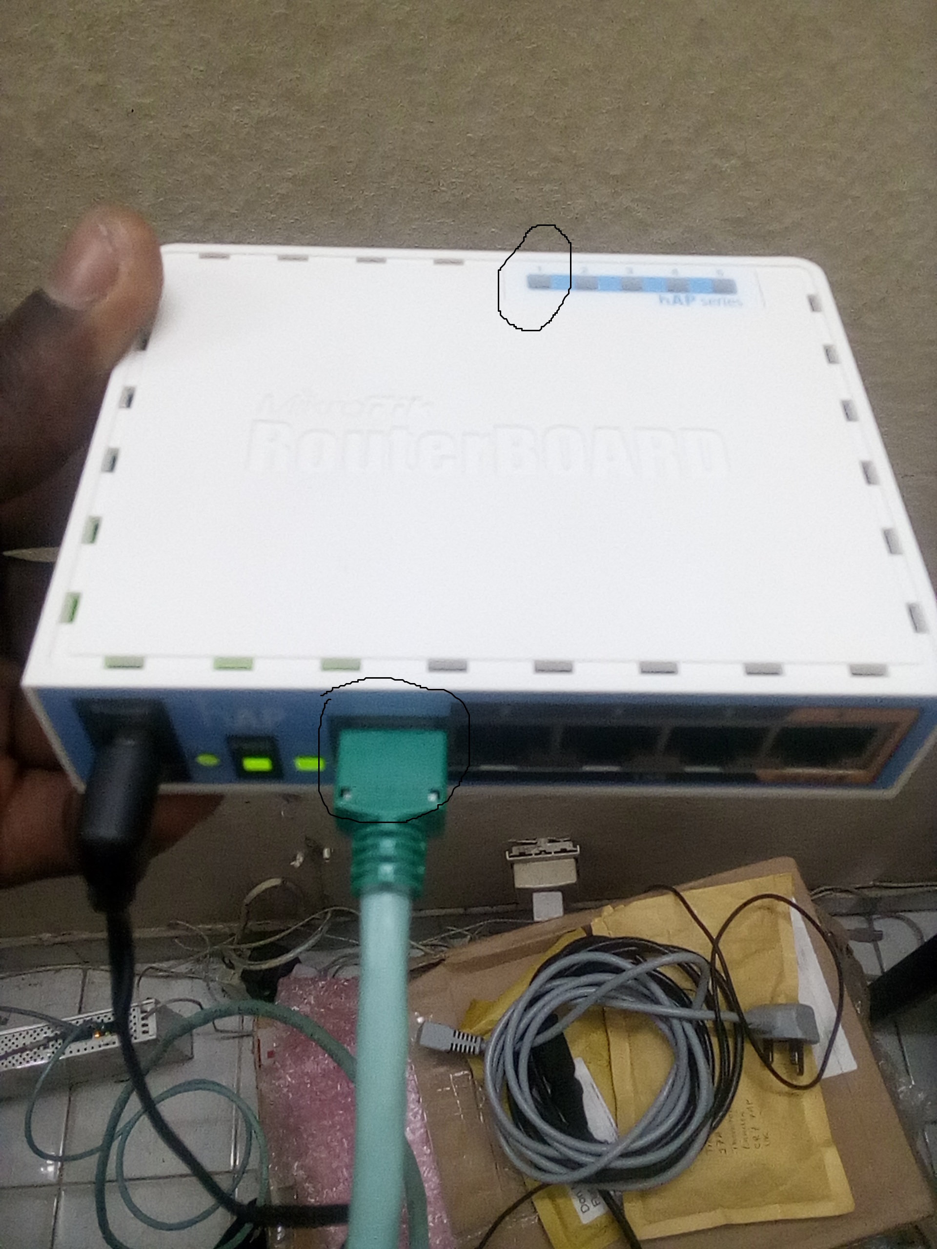

After validating the reboot, we waited about 10 minutes and noticed that the Internet and Lan 2 LEDs did
not turn on after the restart. Then we unplug the router and wait a few minutes before plugging it back in.
Since this operation, the LEDs (Internet / PoE in, Lan 2 - 3 - 4) will no longer light when a cable is
connected to each port but the PWR and USR LEDs are lit.
