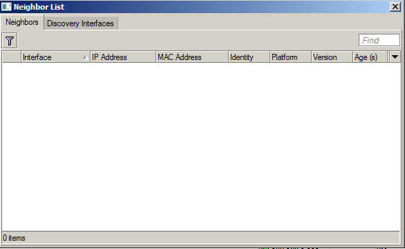

Blank
Neighbors have nothing in it.
I’m using winbox
are you talking about network neighborhoot in windows? we would need to know how your network is set up to answer this
That is the RB450 window in winbox, blank.
I don’t understand. screenshot please :slight_smile:
That the area Chupaka said to go
no, I mean - picture of the problem please. What do you want to do exactly?

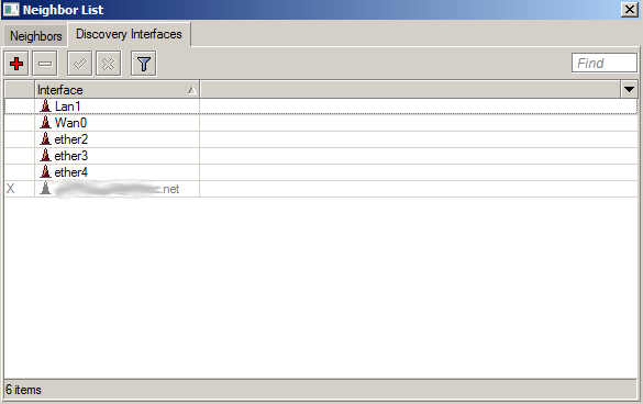

And
this window shows nearby MIKROTIK routers. what did you expect to see there?
