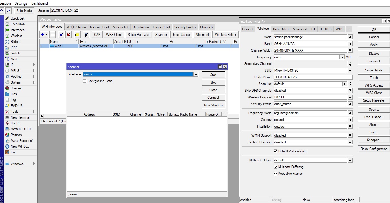

No networks on wlan1's scan list
I just got my Omnitik 5ac and have strange issue… I cannot see any network on wifi scan list (wlan1).
The configuration is the default one - just as came with wlan1 bridged with ether2-5.
I have changed bridge’s ip, added wifi security profile to match AP settings I would like to connect to, changed country and changed device password.
Please look bellow more details.
Have no clue why I cannot scan any wifi networks.
Could I ask for help on this matter please?
Thanks.

OK, I have found some solution. After 10+ tests it appeared that DLink AP was visible with the following settings:
Frequency mode: regulatory-domain
Country: etsi1
Installation: any
Could someone explain, please why is that? Why it does not work on regulatory-domain/poland/outdoor settings?

I’m guessing these 5490-5710/a,an20,an40,ac20,ac40,ac80,ac160,ac80+80(27dBm)/dfs,passive I should use, right?
Now, I’m a bit confused, because I have changed settings to Frequency mode: regulatory-domain/Country: Poland/Installation: outdoor and it works!
Yesterday I have changed the channels from 36 to 100 (my router Huawei works on 36 now - and I cannot see it - but this is not an issue).
Possibly, I made the changes to fast…
I’ll let it work as it is for a few hours and will see that the end result will be.
