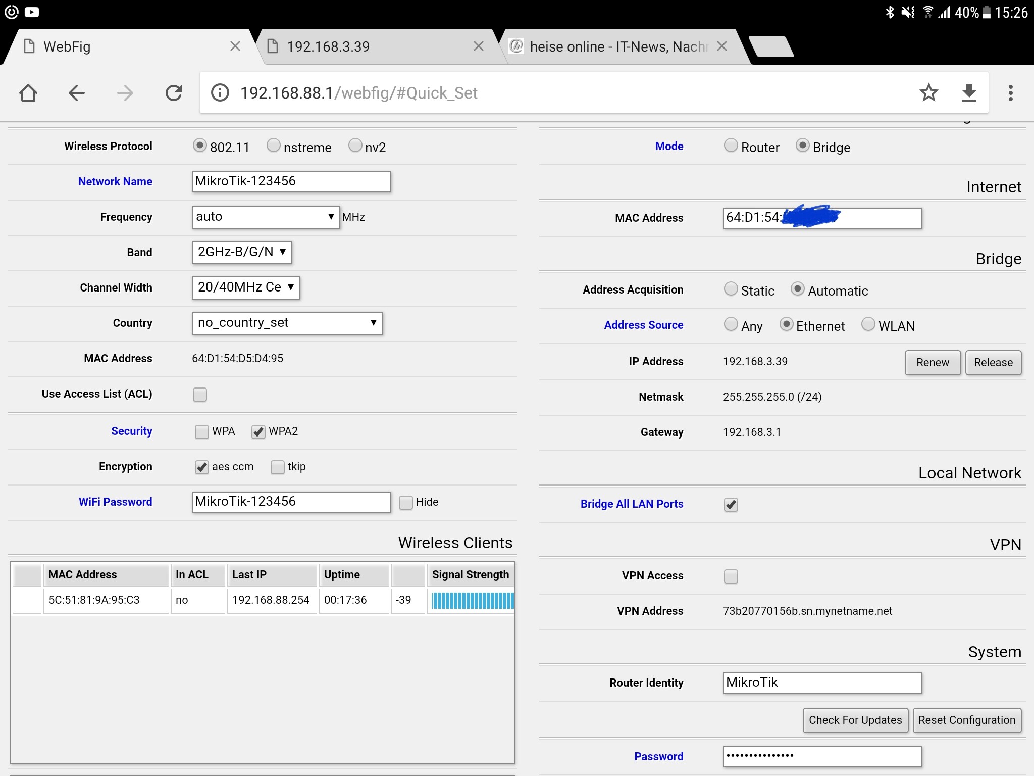

But I can’t configure the map anymore. There are no open ports on the device. I scanned the ip adress for open ports: nothing. No http (80), no ssh (22), no ftp (21).
These are the settings, I’ve configured:
Where is the mistake I’ve configured?

If somebody get’s the same erros. It it caused in the special hardware configuration of the lite ap. Because you have only one wired connection and this is used for the wan connection. Because you have to configure it in several steps, in the first step you kill you configuration connection over WLAN.
Solution:
Configure it with WinBox, so you communicate cia MAC-address in the same subnet. With this I could configure all necessary steps.
