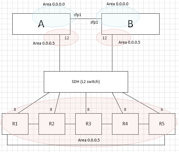

hello. I have a very strange issue, where ping/tracert does not pass via L2 switch to connected router, but pass via transit OSPF router instead, if OSPF protocol active on IP interfaces.
What is the reason for this?
On network diagram, tracert from Router A (source ip from interface 12, source interface 12) to Router B (ip from interface 12) does not pass directly via local link from interface 12 to interface 12, but pass via one of Rx. No ARP record for Router B in Router A ARP table.
If OSPF turned off on both A and B on interfaces 12, then ping/tracert works from if 12 to if 12.
Also, if Routers A and B added as Static neighbors to each other, ping also works via local link (from if 12 to if 12).
OSPF interfaces ports 12,8 are ptmp with static neighbors (Router A, B, R1…R5).
On all Routers LLDP records are correct, so L2 visibility is fine, full mesh.
Is it my lack of some basic OSPF knowledge or some unique bug?
Network diagram is:
