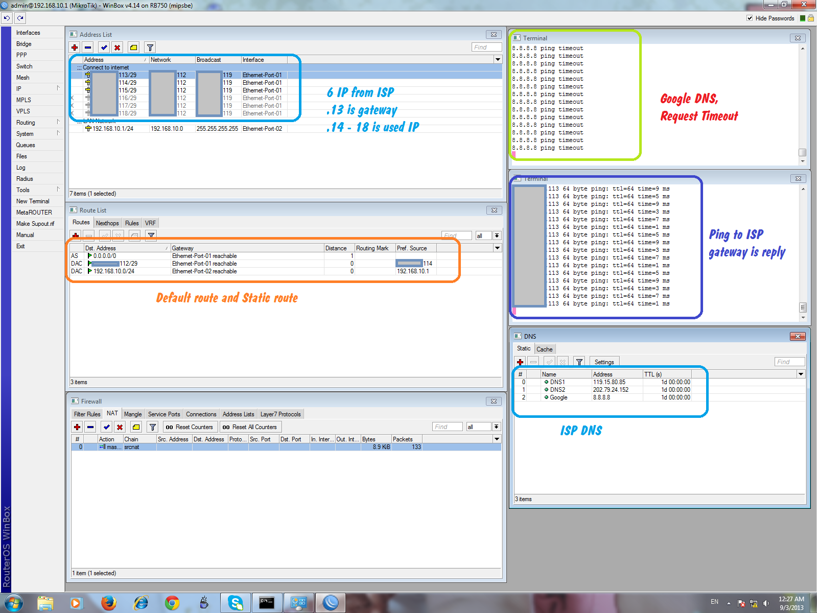

Hi friend, I have problem with my connection on RB750, I already configure, I can ping to gateway normal but to DNS or internet can not.
I have attach the snapshot could you please help to share your idea?

Is the note on the right correct? If xx.xx.xx.113 is the gateway, you should not have it assigned to the router’s interface. That should be the ip in the default route (0.0.0.0/0).
When you ping xx.xx.xx.113, you are pinging an ip assigned to ether1, not the gateway.
Dear Tim, ok i will delete .113 in router. How about other configure?
Remove xx.xx.xx.113 from “/ip address”.
Open the “ip route” section. Double click on the default route (0.0.0.0/0). In the Gateway box, enter xx.xx.xx.113. Click Apply button.
