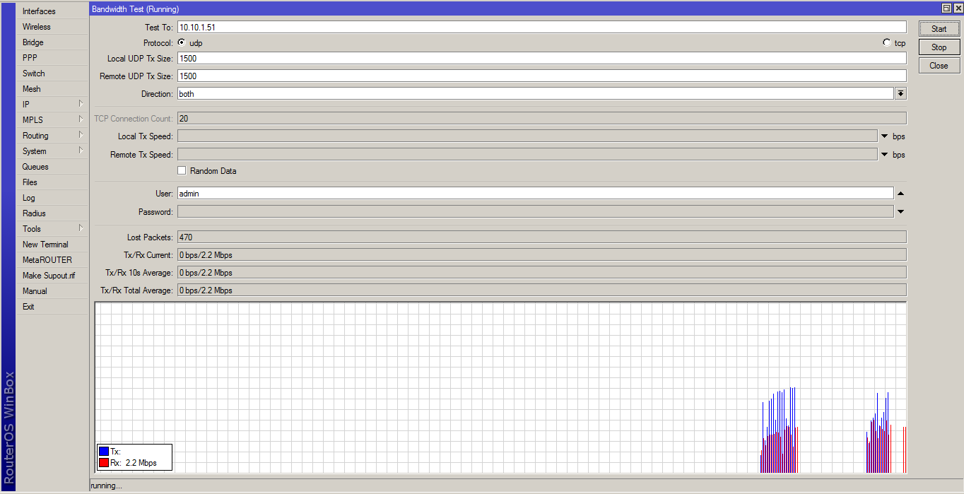

today i setup a bridge between 2 RB711-5Hn-MMCX in a 22dbi antenna enclosure.
both in the same room a few inches away.
i then setup a MPLS transparent bridge using the steps given here : http://wiki.mikrotik.com/wiki/Transparently_Bridge_two_Networks_using_MPLS
now when i transfer data from one PC to another PC i don’t get speeds above 1.5 MBPS at the most 2MBPS. Not above that.
anything i need to do more about this setup for gaining speeds above atleast 20MBPS…

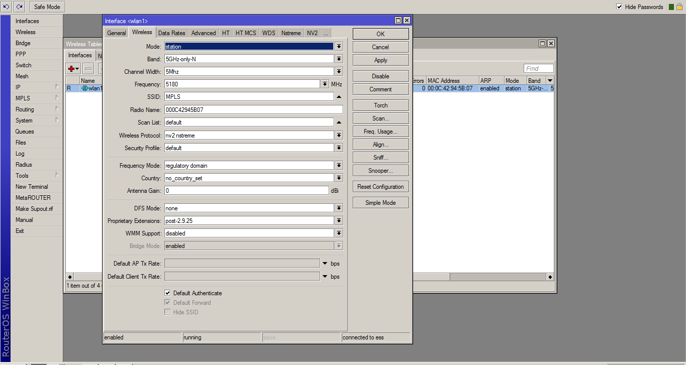

any place where i can see the bridge setup?? without using MPLS… because i somehow misreably fail when i try to do it using WDS and bridge. my RouterOS is Level3 hence i don’t even have a AP mode.
You dont´t need Level 4 for PTP Setup. Just set Mode “Bridge” on the first and Mode “station-bridge” on the other - no need for WDS.
http://wiki.mikrotik.com/wiki/Manual:Wireless_Station_Modes#Mode_station-bridge
Additionally you have to add a bridge and bind both wlan and ether interface.

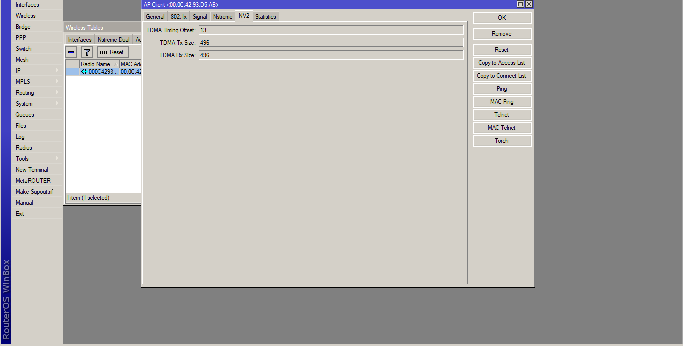

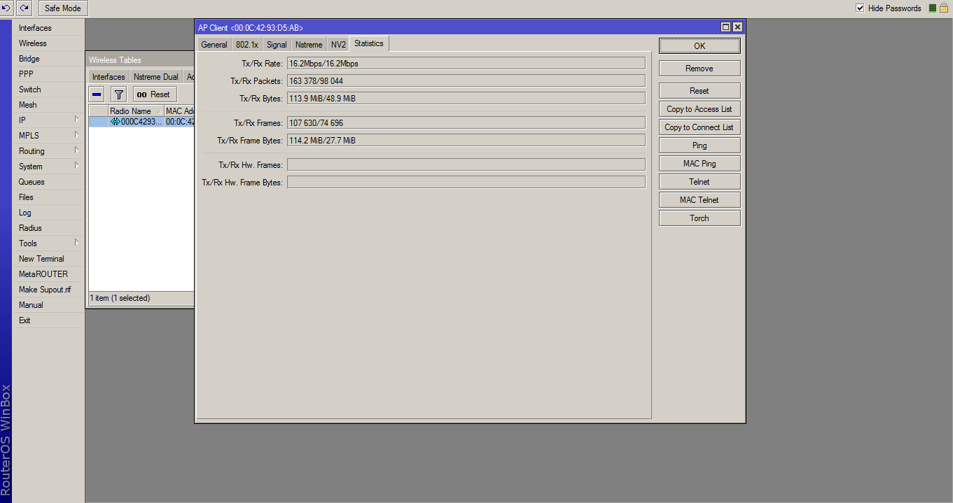

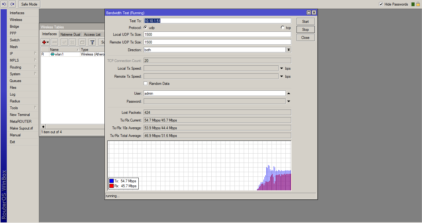

today i enabled NV2 and the Bandwidth Test gave me speeds of 200MBPS
when i tried actual file transfer from PC to PC it was not above 700 KBPS… :frowning:
why is this happening??..
Do you see any errors or drops at the interface statistics?
packet drops yes… during the Bandwidth Test in UDP
either in RX or TX or Both
