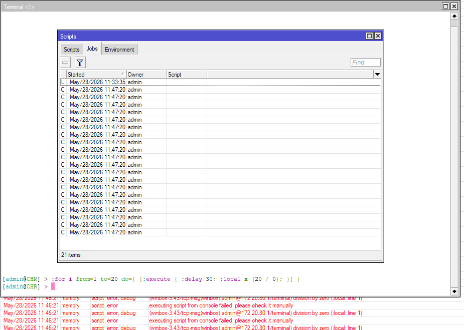

I think it still writes logs for errors? And :execute spawns a background task, which I assume involves a new thread or process? and would be quite resource intensive. I tested with:
:for i from=1 to=20 do={ [:execute { :delay 30; :local x (20 / 0); }] }
to confirm that errors are logged and the background task runner is NOT reused (each :execute has its own job).
It remains to be seen whether parallel execution improves speed when the records are 200k and whether more than one processor is used or not.
