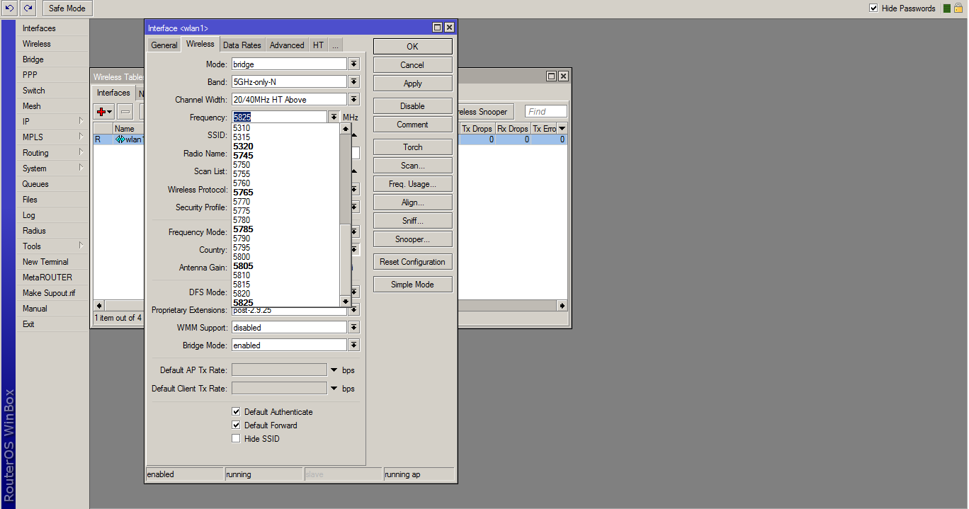

in the drop down menu for selecting frequencies i have no option beyond 5825.
5825 is at the end of the list.

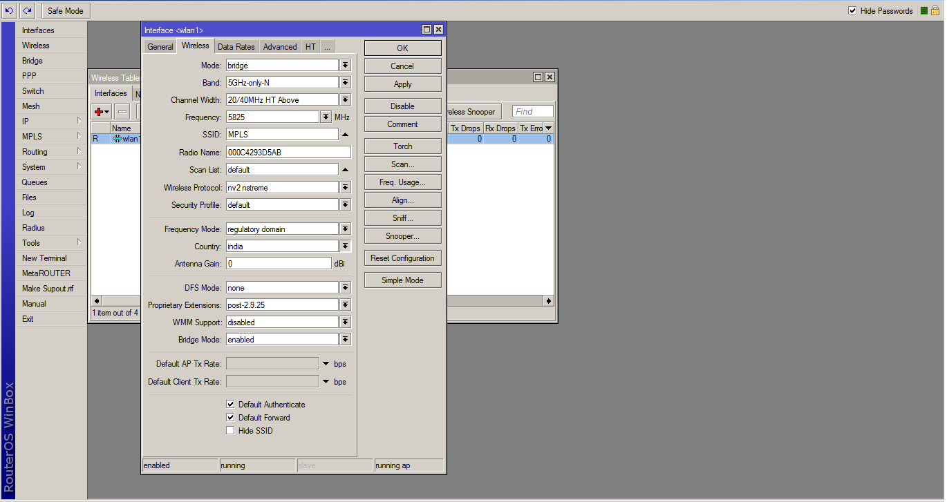

did you set wireless mode to “regulatory domain” and country to “India”? if no, please do so, and the dropdown list will contain frequencies allowed in India.
hi normis…
i tried what you said.. still no luck :frowning: screenshots attached below:
although when i shift to SUPERCHANNEL i can see a lot of frequencies… but when i switch to any more than 5825 on both the link fails…
please help.

if your link fails, it means that the other end of the link doesn’t support the selected frequency. what device is on the other end? if it’s a mikrotik device, you need to also configure scan-list in it.
RB711-5Hn-MMCX at both ends.
Link does not fail.
No frequency beyond 5825 in the dropdown table.
in this case, other frequencies are not allowed in India. if you think the list is wrong, email mikrotik support with a document that shows which frequencies are allowed in india.
