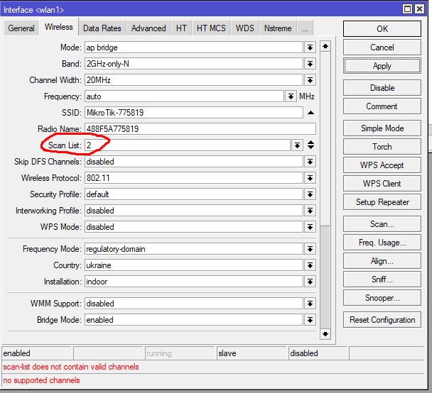

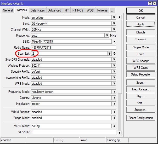

I recently encountered this problem when I set my list of channels 1, 6, 11. It turned out that there were continuing problems with the scan list name. If the name of the sheet begins with a number, we get an error message, if with a letter, everything works.
Also, if there is a dot in the list name, then the list name is imported incorrectly when exporting-importing the configuration.

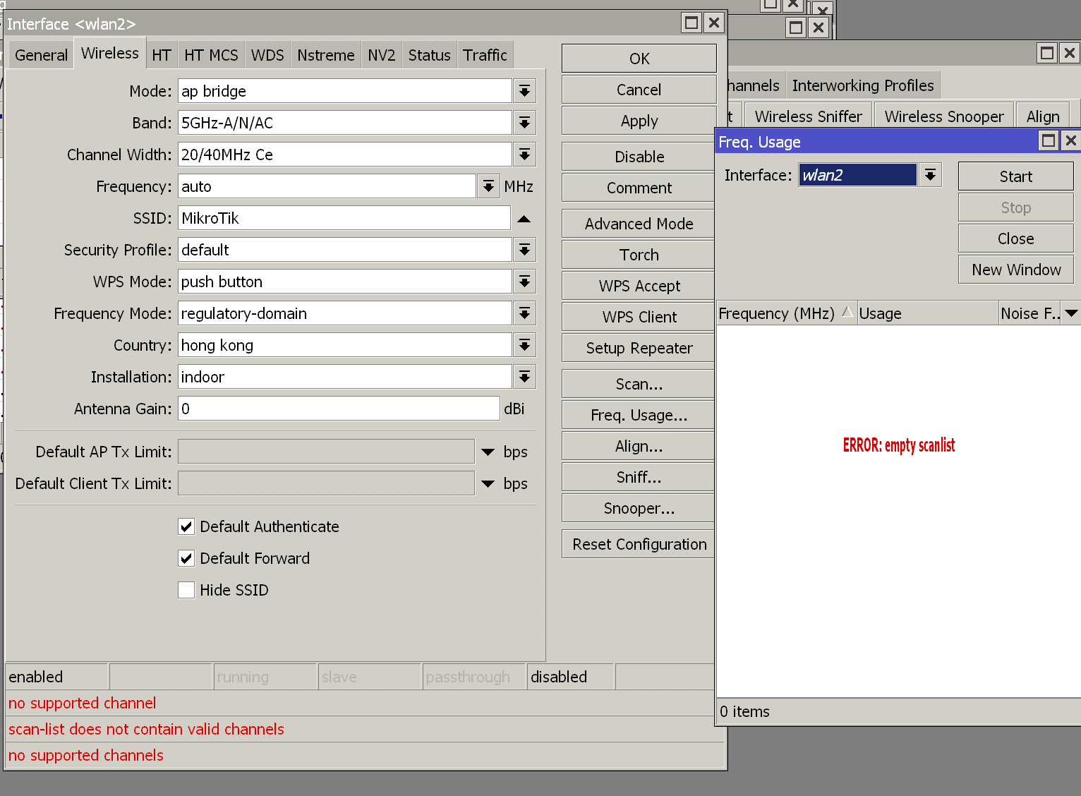

I am using an x86 and install an MikroTik R11e-5HacT
Always no supported channel
Set installation to “any” … the way MT understands the “indoor” is very restrictive … device will select only channets which are allowed exclusively for indoor use … and there might be none. Usually all channels are allowed for indoor and outdoor, but allowed Tx power might be lower when used outdoor.
You may also want to change band to “5GHz-n/ac” (omit a) and (for starters) channel width to 20MHz only.
