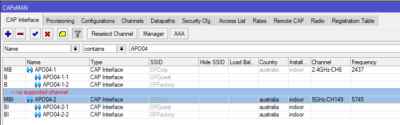

"No supported channel" in CAPsMAN when using channels 149-165
I have got a site in Australia where I have installed 8 NetMetal AC’s and 4 CAP ac’s.

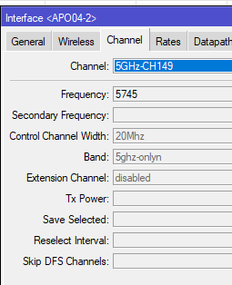

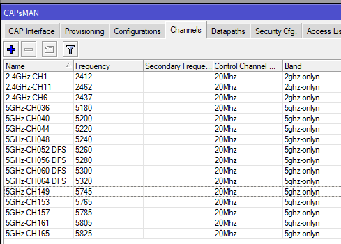

The site all works well, however whenever I select 5G channels 149-165 I get the error “No supported channel”
I don’t know how to fix it, as if you take the CAP out of CAPsMAN mode, you can select the channels fine.

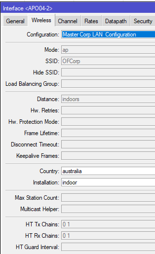

I made sure I set the Country to Australia.

I removed the country in CapsMAN and now it works.
I found the solution. Need to set the Installation to Outdoors.
Installation: Outdoors or any. “Any” if the installation is actually indoors. As Mikrotik in some cases makes the mistake denying outdoor frequencies if set to “indoor”.
There are “indoor only” frequencies and “unrestricted” frequencies, and as such allowed outdoors. There is no mentioning of “outdoor only” frequencies in the regulatory documents.
The word “/outdoor” should not be in this list (or the software logic should be different)
