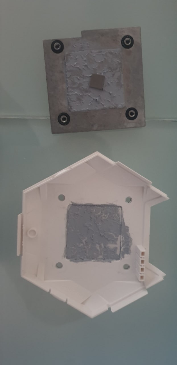

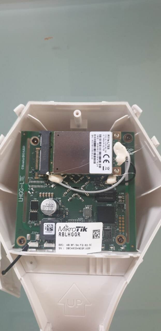

From lte cat.16 lte modules are hot… and have a option to disable CA (back to 1x band only) for cool-down… and that’s new LHGGR have them but module must be as mPCIe only (means Telit who not support Cell Lock ).
for R11e-LTE6 we use it just without any additional pad.
Check the LHGGR inside:
