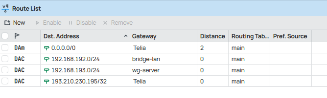

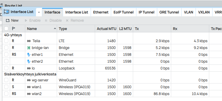

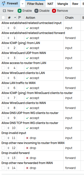

The issue is, that the LAN and LTE do work. However, the Wireguard connection makes handshare correctly and connects to 192.168.193.0/24. However, with the Wireguard connection, I just cannot ame the connection to work so that any traffic would be moved.
I have attached three screenshots to this post of the settings in IP > Routes, Interfaces and from the firewall rules.

You should provide configuration from the both routers, LTE and the router on the remote site. Just redact sensitive information like public IPs, wireguard keys etc.
