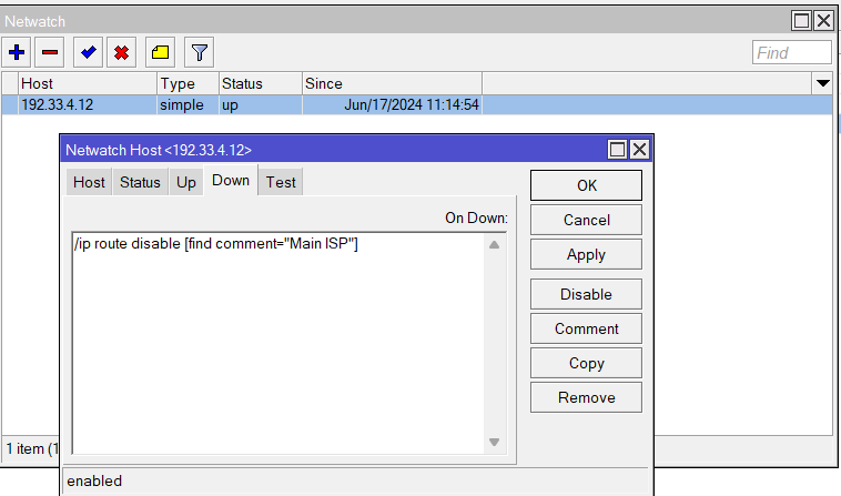

  1. Whats the purpose of this rule… ???
    add disabled=no distance=10 dst-address=192.33.4.12/32 gateway=192.168.1.1
    pref-src=0.0.0.0 routing-table=main scope=30 suppress-hw-offload=no
    target-scope=10
(7) What is the purpose of the masquerade rules???
Thank you for your input.
All VLANs are going out to the internet. I made the HOME VLAN rule allowing LAN-VLAN, AP-VLAN, and Camera-VLAN to have full access to each other. Cakes-VLAN can’t access HOME VLAN but is still able to access the internet.
So WAN2 is only used as a failover. The purpose of this rule (item 6) add disabled=no distance=10 dst-address=192.33.4.12/32 gateway=192.168.1.1 \ is to monitor if there is internet connectivity on ISP WAN if not I have a script to disable the primary route.
For the masquerade rule, I just want to see which interface the internet is using, so I have 2 masquerades.
