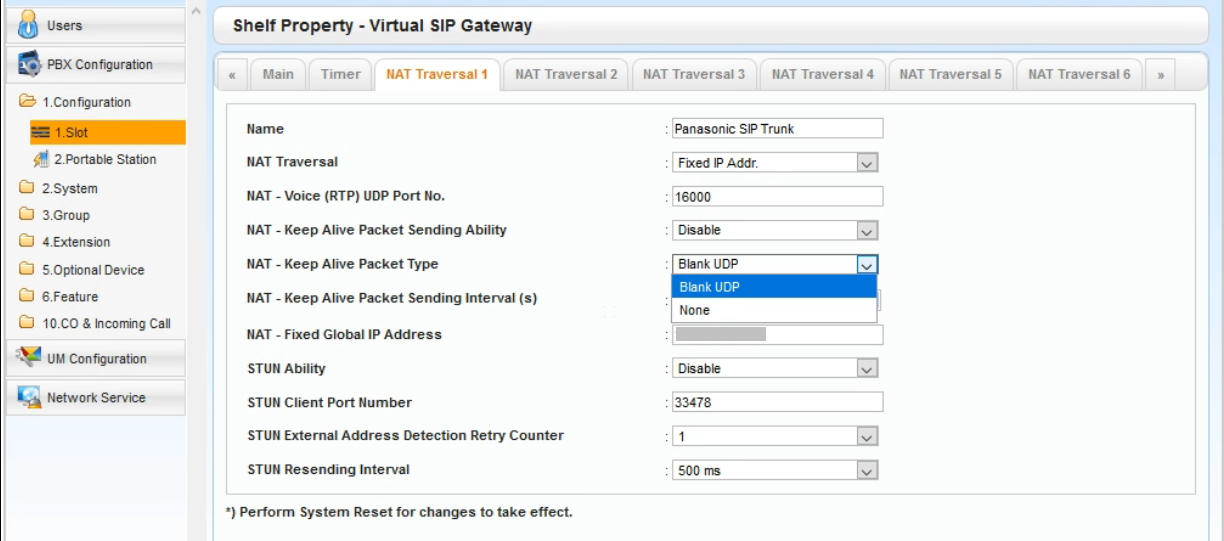

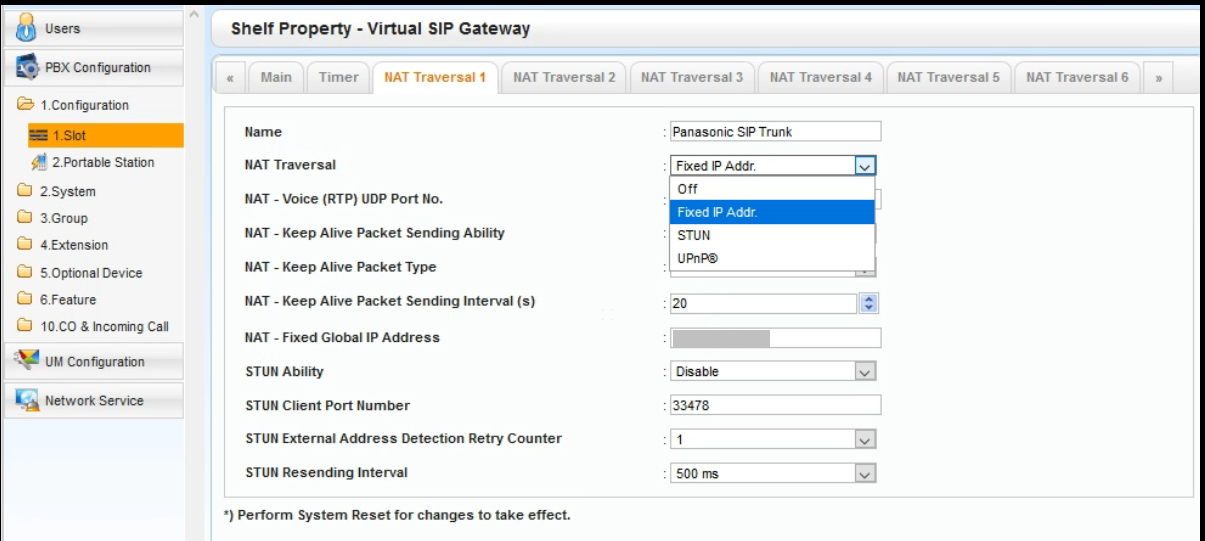

“The RTP voice, is between the SIP server 199.48.65.2 and the IP of the DSP 192.168.0.102. If a response is outside the range 16000-16511, the voice disappears (the DSP only listens on ports 16000-16511 UDP). Most of the time that I see this problem, it’s an option in the router that relates to VOIP / SIP. We have already verified that they are all OFF. But it is possible that there is one option which is more deep in the firewall.”

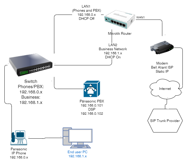

I’ll post my config below. Here’s also a Network diagram. I’d really appreciate if someone would have a look at it and check if I’m doing something wrong here.

I see that there’s an option in the PBX to send “Keep Alive Paquets”:
Setup: PBX Configuration: Configuration: Slot: Virtual Slot: Select Shelf: V-SIPGW16: Shelf Property: Nat Traversal 1: NAT - Keep Alive Packet Sending Ability.
It’s set to Disable.
The NAT traversal is set to “Fixed IP Addr.” (Other options are : OFF, STUN and UPnP).
Could it be that we need to enable this option: NAT - Keep Alive Packet Sending Ability?
