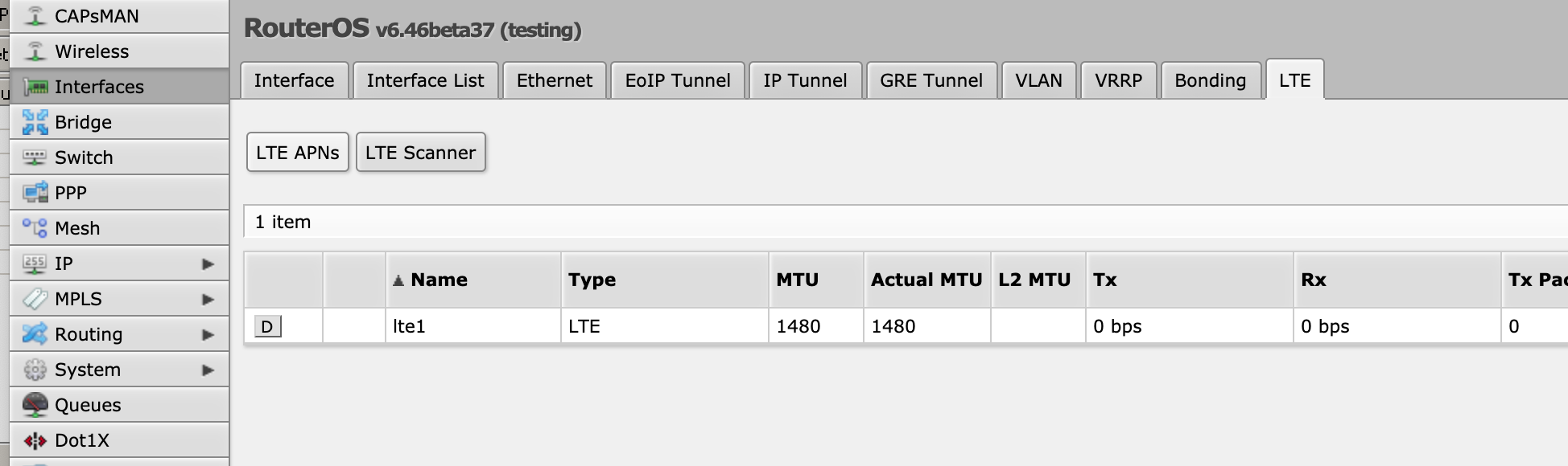

I go to Interfaces → LTE → Edit, and select the APN. Once I hit [Apply], the view refreshes and my changes disappear. Same happens if I “enable” any of network modes. See screenshot…

the APN profile is a drop down list that provides choice of preconfigured APN profiles, you should configure a new APN profile first, then select it
This can be done in “interface → LTE → LTE APNs → Add new”
Also, QuickSet in your version did not yet support dual band LTE AP devices, like yours, a newer RouterOS version is required to be able to use the QuickSet
Yes, I have added an APN in APNs list and I can select it in interface settings. However my selection disappears when I apply the configuration.
I have just figured out my modem is working in HiLink mode instead of stick, and it offers web interface of it’s own. So I have set the APN there and it seems to work.
