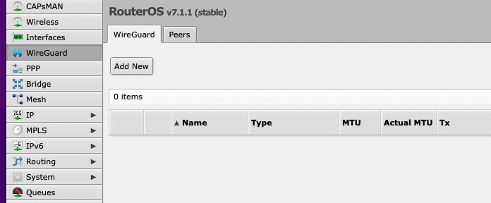

There it is on the left side menu, below Interfaces. Make sure you clear your browser cache and reload the page a few times.
It was browser cache. Thank you.
