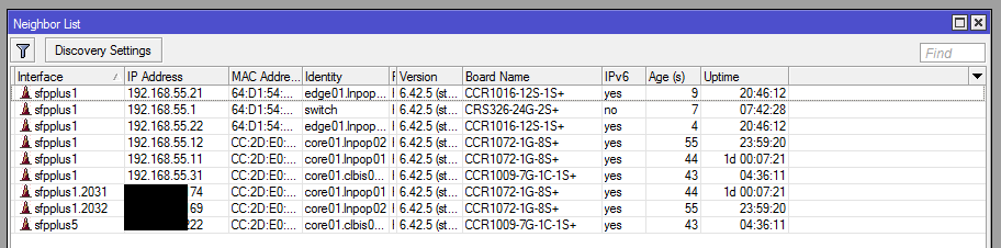

Thanks, yes I understand that ingress-filtering only applies to ingress traffic. And there are no untagged VLANs on this port. So there should be no untagged packets on ingress or egress. The only possible traffic from this port should be on VLAN tags 2031 and 2032.
Yet here are the neighbours of the router directly connected to port ether11 in the above example (the local port is sfpplus1)
It should have no neighbours on sfpplus1 at all, only on the VLAN interfaces sfpplus1.2031 and sfpplus.2032. It simply should not be able to pass traffic to/from the devices in VLAN 1, that is the whole concept of VLANs, that they should segregate traffic. Somehow VLAN 1 is leaking into these ports (bidirectionally - the other devices on VLAN 1 can see this router too).
