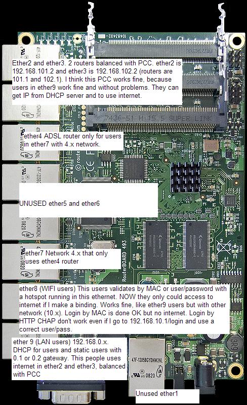

PROBLEM: The hotspot login page is not displayed automatically and when I use 192.168.10.1/login to login manually, the users logged don’t have Internet.
I configured the system with PCC, LAN users without validation and hotspot users with validation.
The LAN users (ether9) can use internet without problems and with the PCC (ether2 and 3) working fine.

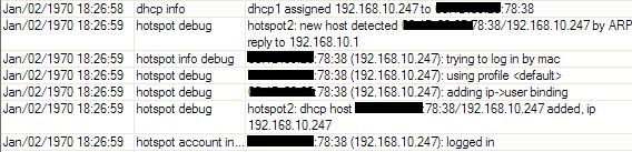

The Hotspot users (ether8) ONLY can use internet if I make a binding with the IP/MAc of the user. If I try to validate the user with MAC, the user is validated (log show it, YOU CAN SEE THE ATTACHMENT) but no internet. I’m trying this using only 1 PC connected directly to ether8. If I make a IP binding for the same MAC, it has internet without problems. SAME RESULTS validating it with user/password, but the hotspot login is not working automatically, but If I access to 192.168.10.1/login, I can login but no Internet. Why the WEB don’t work automatically? It could be a problem with the NAT? DNS are OK.
