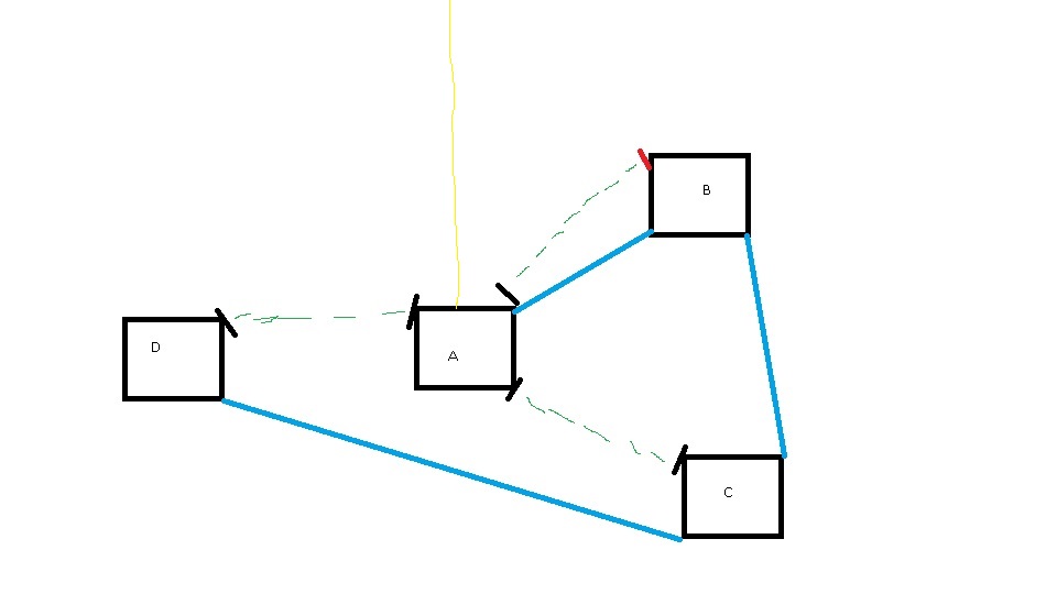

post a diagram
ok so here is a terrible network diagram but to give you a idea.the airfibers point to one central location each building has a lan connection already but at time of installation this was not provided. as of right now we are running just on the airfiber, but we would like to have it run through the lan and have the air fiber as backup. i cant give info on what the lans are as we are still waiting to hear that. i thought i had it licked the other day but its not working .so, but i believe that is due to me testing this on a single network and not having two separate networks ( testing long before install as its working fine as is but we would prefer backup.

assuming A, B, C, D are locations (each having a routeros equipment) what are the blue lines, the dotted lines and the yellow/orange line?
sorry i forgot to mention what those were, blue line would be lan connection green is the airfiber and the yellow is internet line, hence why im thinking i dont need two wans ( if i was to put the airfibers on the same network mask) i just need to make sure i have a failover if say the lan drops it would switch to the airfiber
what you need imo are bridges with stp enabled and small path cost set on the ports in which lan cables are connected (the path with the smallest path cost is the preferred path).
http://wiki.mikrotik.com/wiki/Manual:Interface/Bridge
thanks deejay i was looking into a bridge but wasnt 100% sure if it would work for what i would need.
