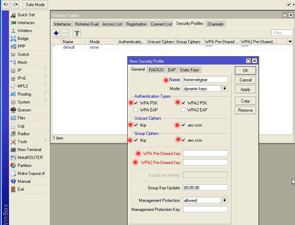

Go to “wireless” and than to “security profile”
by “name” give you the new profile a name
There can jou setup the wireless security
I click all the options aan wpa, wpa2, tkip, enz
See the printscreens that i made

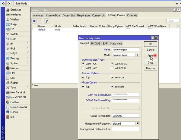

Give by wpa and wpa2 a kye and save this profile.
Go to the wireless settings and there see you “security profile”
select the profile that you made
Try than to connect to the router
I don’t know what happened, but after creating the second security profile I can connect using the default (which is configured exactly the same). Confused but happy it works, thanks plisken. Upped your karma in gratitude, wish I could buy you a beer since I’ve wasted hours screwing around with this. :smiley:
