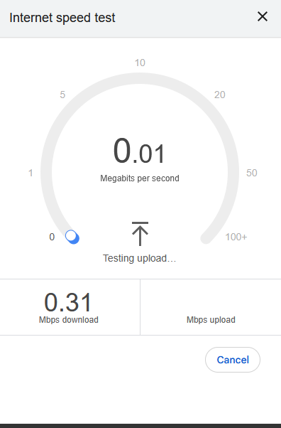

I was able to obtain IP address from my ISP, but the internet is extremely slow, does not matter if wired or wireless.

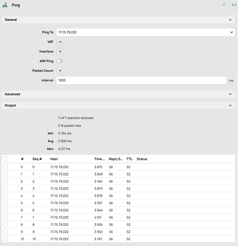

Ping that took 4ms on old router now takes about 1000ms. I have default settings and did not change anything as I do not understand pretty much anything in the settings. Cannot run bandwidth test because I dont have idea what ip to use to test.
If I ping router from computer it is below 1ms, if I ping from router some internet IP it is ~4ms as with old router, but if I ping from my computer it is ~1000ms.
microtic-cpu
But as visible on the screenshots, the ping sometimes drop even on my computer to proper values. To me it seems like if some bandwidth limit was set somewhere and my computer is using that limit most of the time with some requests.

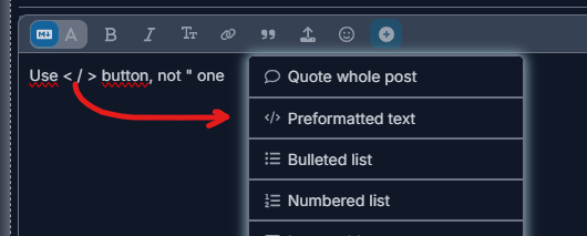

Use < / > button, not " one
