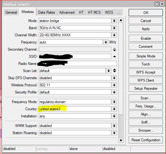

I have an LHG 52 ac or RBLHGG-5HPacD2HPnD that I am trying to change the Country from United States 3 to United States on and it will not let me.
Slave-Tik] > interface wireless set country=“united states”

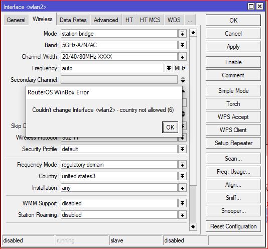

numbers: 1
failure: country not allowed
The lock is in place intentionally - because device is only certified to be used with these settings.
