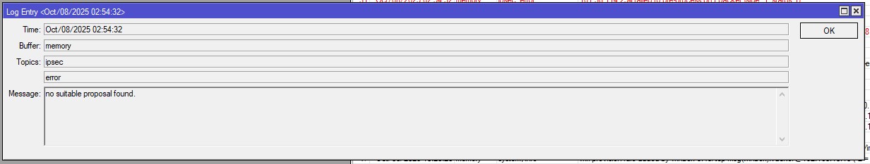

I have the same issue, since downloading the newest available version (3.43).
Until the last version, the content of the Message box could selected and copied. In the new version it cannot be done - which would be important in order to copy IP addresses, messages, etc.
The texts in the other fields in the window (time, buffer, stb) can be select and copy
Please fix this issue.

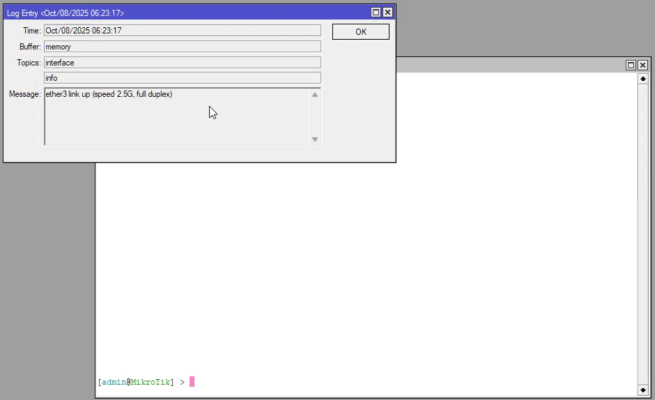

Just right click and copy works for me:
winbox-log-copy
Thanks. I tried and this way works.
But would be good to return to the previous way - in most cases we need only a part from the whole text - for example an IP address or MAC address.
I do not understand the logic why cannot be select only that box - and can be in the upper ones.

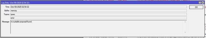

The issue that confuses people is that there is no highlighting for selected text. Copying parts of text works fine, but you have to do it blind :>
That's something entirely else !
But yes, there is indeed no highlighting visible, tested on RB5009 with 7.21b2.
However, on other RB5009 running 7.19.3 however it DOES show.
Both using latest Winbox.
So the issue was not only badly described, it also depends on ROS version.
It started with 7.20 since that is when they changed element used for log rendering from single-line to multi-line.
In Winbox 3.xx is still not working, but in Winbox 4 works this way - you can select/highlight the part of the text
WinBox 3 is now fully EOL and removed from Downloads page, so I don't expect any future fixes or support for new ROS versions to land there.
