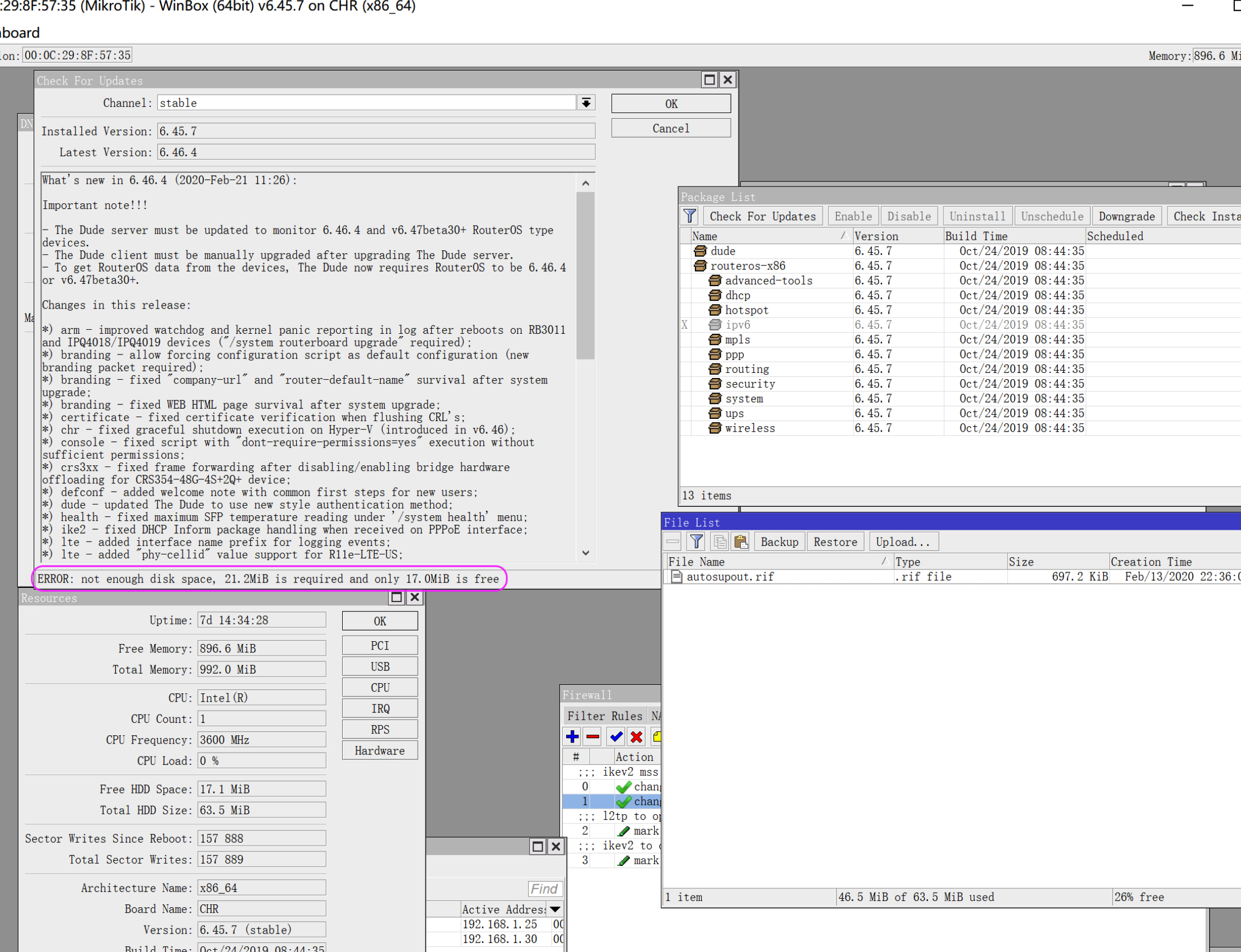

not enouth disk space
my english is bad…plese help me, thank you,i use esxi
Shutdown the CHR and increase the HD size in ESXi allocated to the CHR. Restart the CHR and it should automatically pick up the increased disk size. You could also add another virtual drive in ESXi for the Dude files. This will stop it over running and crashing the router when it runs out of space.

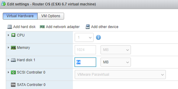

Should I adjust disk space directly here?
Yes.
