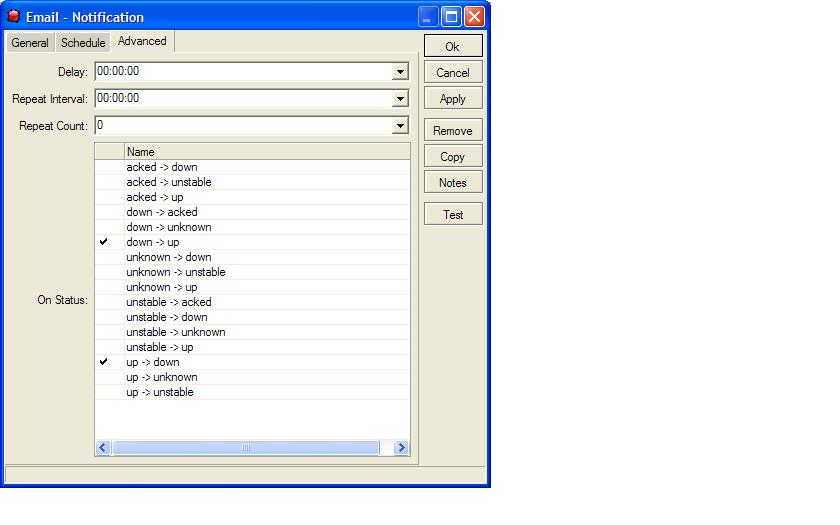

I don’t seem to be getting notifications when things go down, only when they come up. This has been a problem for previous versions I’ve used (3.0 beta :sunglasses:. Anyone have any ideas?
add “unstable->down”
and unknown-> down
I have the same issue with not getting down only up.
If I add unstable>down I get email within a minute, I don’t want unstable>down
I want down after 5 minutes.
which is how I have it set up for.

configure your pollings timings. section probe down time and probe down count

Seeing how no one knows out to explain this I will try:
If you want to receive notice that something is down you need to look first at how the Dude looks at the status of a device.
Here is the order of things
1st 2nd 3rd
Up → unstable → down
So if you want notification when it’s unstable put a check next to: up → unstable
if you want notification when it’s down you would put a check next to: unstable → down
and for when it’s back up from down you would put your check next to: down → up
or for when it back up from unstable put your check next to: unstable → up
I only look for Status of Down and then back up.
So I only have checks next to
unstable → down
down → up
