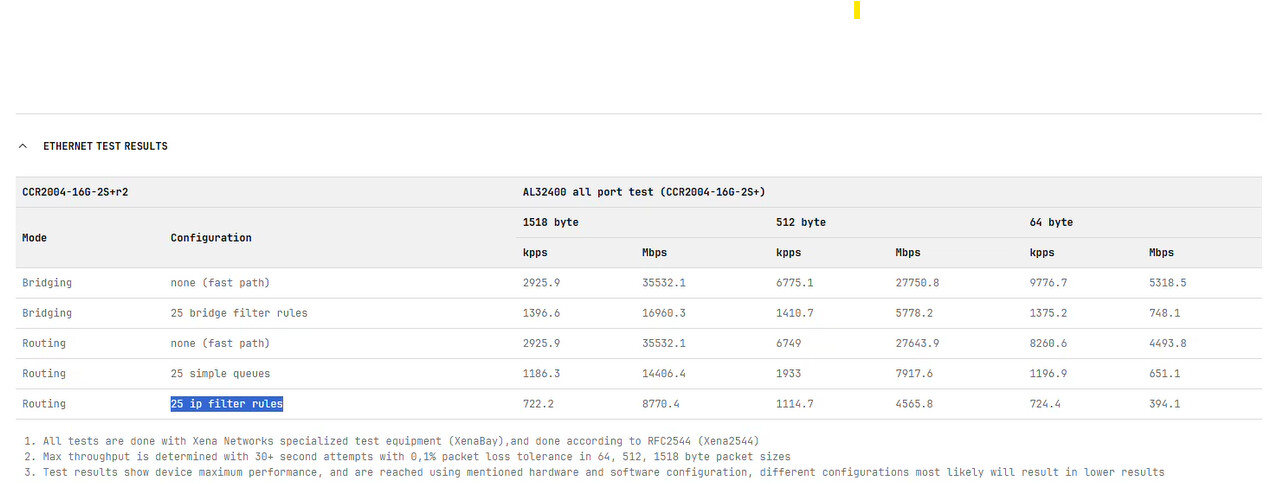

I have a 10G circuit, when my firewall rules are enabled. I only get 6-7Gbps, when i disable the rules i get 10Gbps up and down. Does anyone know what could be causing this issue. I am using a CCR2004-16G-2S+ on v7.19.6 here are the firewall filter rules i had enabled that caused issues.

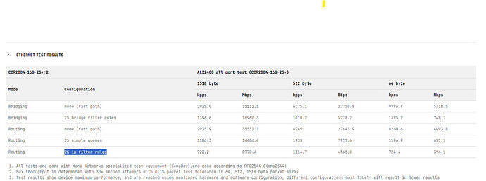

I found the issue, when applying filters to the mikrotik it limits the bandwidth. We had to upgrade the mikrotik to a CCR2116 model and got the 10G with the filters in place
