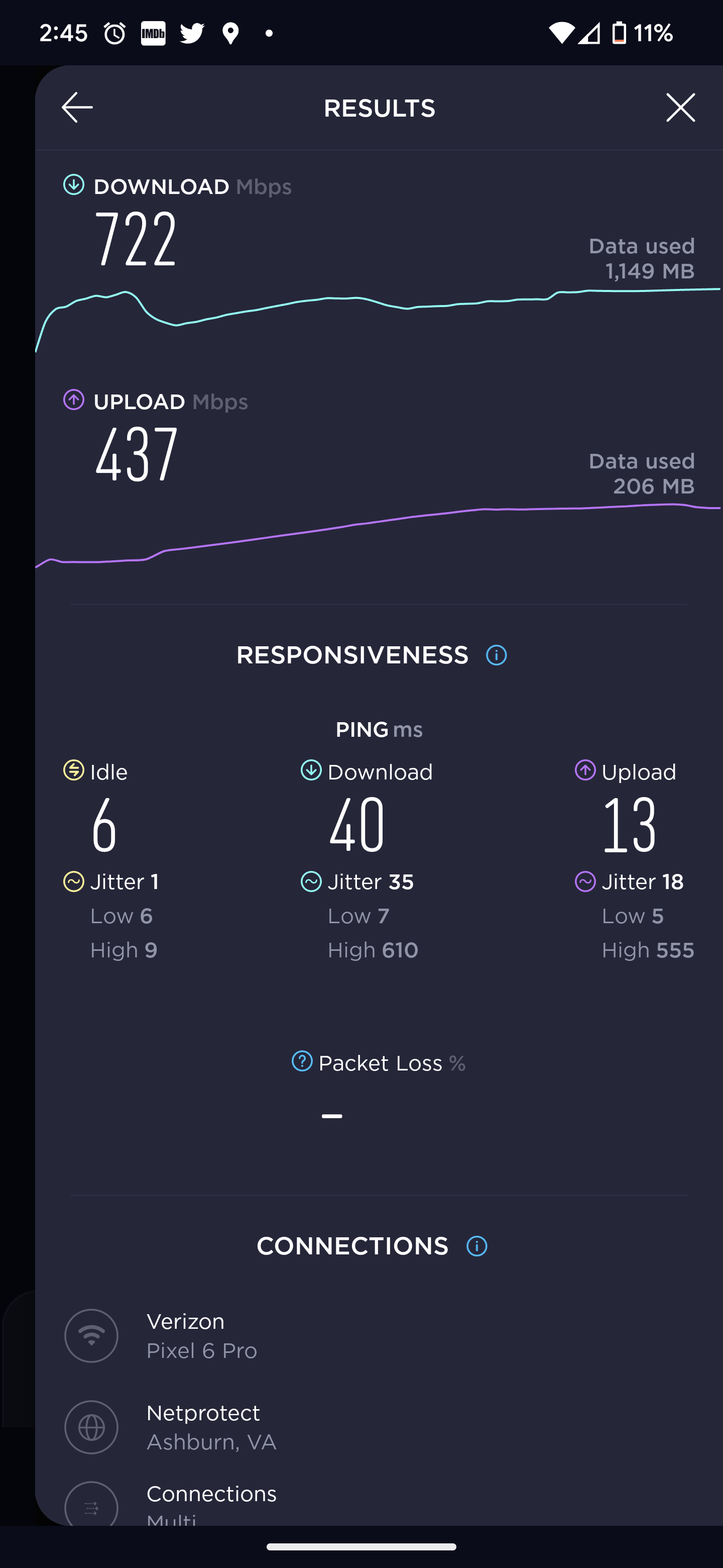

Right now, I have one hAP AC2 as my router feeding a CRS326-24G. Into a Cambium XV2-2 (WiFi6 Access Point)
1Gig internet service.
27 connected clients across 5 SSID.
In an environment with 47 nearby WAPs competing for airtime.
Sonosnet wireless mesh with 10 devices on it.
I was watching YoutubeTV while this test was running. 2 wifi cameras were streaming. And my kid was playing some online game.
