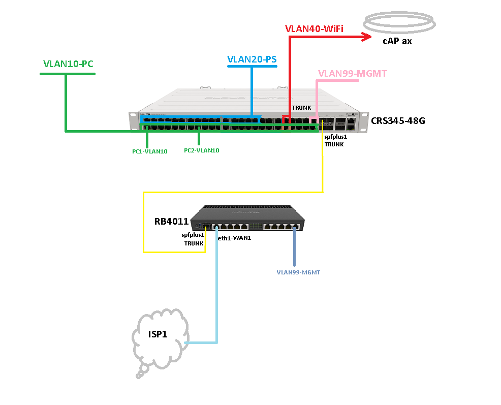

Hello everyone,
After struggling to find the right way to configure my RB4011 and CRS354 using VLANS with QoS and after everything seam to work well, I came to a point that connection, let’s say from PC1-VLAN10 to PC2-VLAN10 not reaching the wire speed when copying between these two PCs while both PCs have Gigabit Interfaces!!
To be honest, the configuration might be a mess and I’m not sure if I did setup correctly but I think that something is going wrong with the hardware offload!!!
This is the configuration at the Router side:

this is the configuration at the Switch side:
# 2024-03-09 13:44:20 by RouterOS 7.14
# software id = XXXX-XXTA
# model = CRS354-48G-4S+2Q+
# serial number = XXXXXXXXW8V
add dhcp-snooping=yes name=bridge1 vlan-filtering=yes

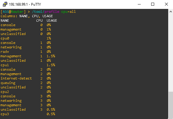

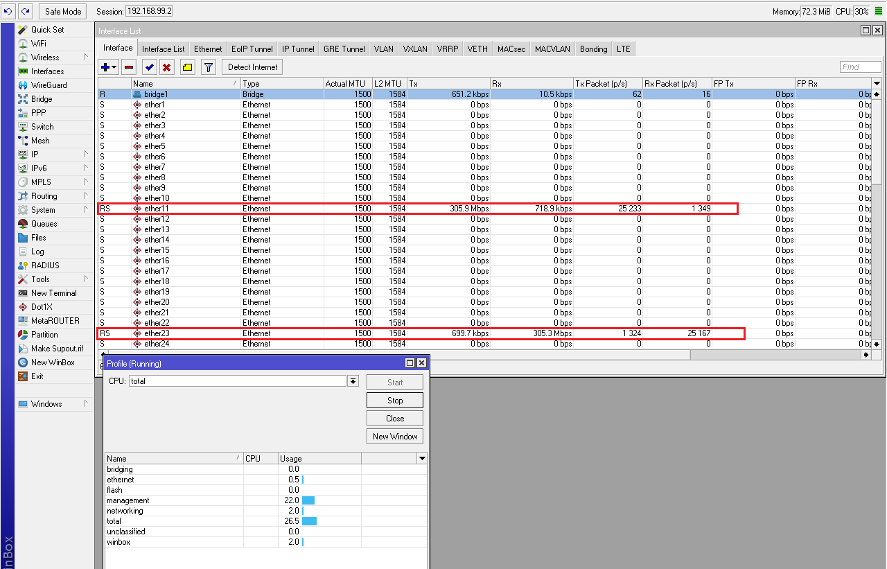

I think, the CPU on the RB4011 is not affected that much while copying/transferring from PC1 to PC2!

If you mean are they connected to the switch, then yes..! Both connected to the Switch accessing router via Trunk Ports for InterVLAN routing!
This is the topology!

Since both PCs are in the same VLAN, there should be no traffic at all towards RB4011.
How is CPU usage on CRS354 during copy ? I am going to guess it will be rather high and that it will be your bottleneck.
In that case something is off on the switch config but I don’t see right away what it might be.
If I do intra-VLAN transfer between 2 devices across e.g. CSS610 or CRS326 (both simple switches), I get nicely 950-ish Mbps speed. And that’s to be expected for Gb links.
So I still think something is not right.

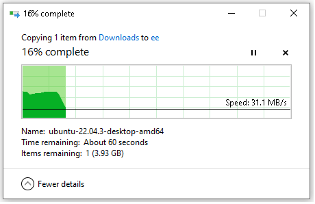

I have reset all the configuration to its default configuration for both (router and switch) and to no default as well and I have tested using bandwidth test which I think this is a L3 test from router to switch and the throughput did not exceed 300-400Mbps which is really strange because these devices are supposed to provide gigabits interfaces!!!
I have tested using file sharing from one pc to another and results are the same 30-50MB/s
Does anyone from mikrotik can explain this!?
Maybe I tried a wrong way of testing but if this is the correct way then it makes me think that Mikrotik does not provide good quality devices!
Note: If the cable category affects somehow, then this might be the issue because I’ve used cat5 utp!
You need to test switch to switch at first.
2 pcs connected to switch, test between both pcs.
Even on a stupid Hex i can get 950ish between ether ports in switch mode.
That’s what I did but same results!
Yup, sounds more like cable or PC issues at this point.

I still had a small issue on BASE/MANAGEMENT VLAN and i still don’t understand very well! :confused:
Anyways, thanks for your help m8s!
God Bless You ALL
