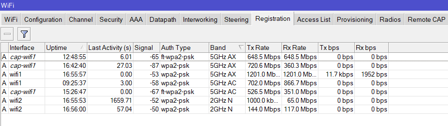

Everything so far I see connection wise on both devices running this A/B is explainable. I have 70 items in my logs of which 25 of those are me logging in to the router which is running as CAPsMAN. The main reason I am trying this is to see if my 1 device that wont connect to WiFi SSID’s with FT enabled which still doesn’t. Look at the device connected since installation @ -87 which by the way is a brand new device. Am I hopeful for people with problems ? yes very.
