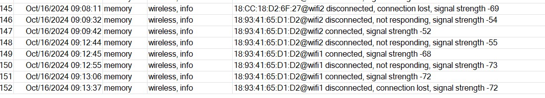

Unfortunately, the problem still exists, only the name has changed
Intel WiFi 6E AX211
*) wifi - re-word the "SA Query timeout" log message to "not responding";
We might have to rename this thread :wink:
