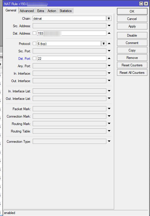

Attached picture wtf.jpg is my synology device showing many ppl trying to connect.. but shows ip of router instead of theirs ip.
and other pictures shows settings in mikrotik for that port forward
I hopw its better explained what i mean
I just saw the signature of one guru member in the forum. it says “People who quote full posts should be spanked with an ethernet cable. Some exceptions for multi-topic threads may apply.”
These images, you just posted, makes me understand that you have enabled port forwarding from port 22 (TCP) of the WAN interface of your router to port 22 of 192.168.0.7.
Is 192.168.0.7 the IP address of your NAS? Can you please explain the problem again?

i have port forwarded port 22, 5000, 5001, 6690 and now changed them from default to different ones 2233, 5555, 5556, 6690(one stayed not changed) just to avoid constant spam from bots trying to acces my NAS.
DSM - means web acces just to clarify from one of the pictures ive attached.
When someone either from web -DSM (5000port), or Cloudstation(6690port) or SSH (22port) it all shows in NAS protocol as 192.168.0.1 and i dont know why.
