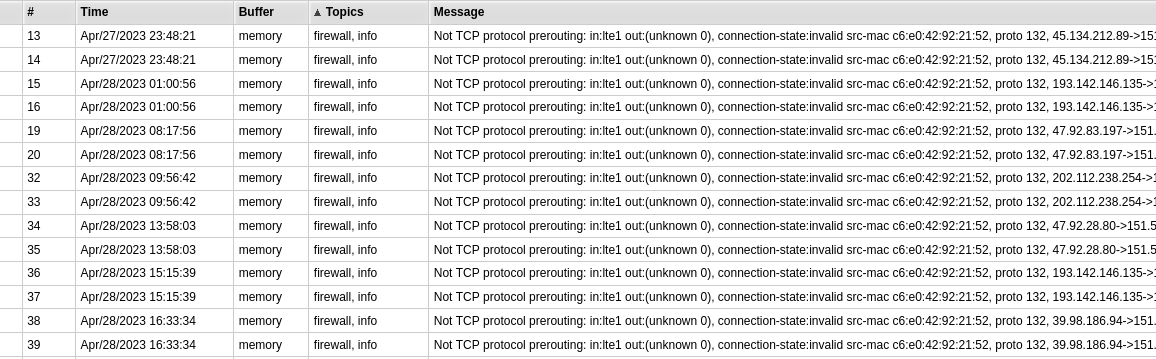

i have an rbm11g with ROS 7.8 stable and an LTE module . in the log file i get about 10 messages a day with this wording:
Not TCP protocol prerouting: in:lte1 out:(unknown 0), connection-state:invalid src-mac c6:e0:42:92:21:52, proto 132, 39.98.186.94->151.15.109.102, len 52
I checked the firewall settings and they all seem to be correct.What do you think it could be ?

@rextended the IPs starting with 47 139 39 202 are not mine; 151… is my IP on windtre. is this a problem with my modem?

Not TCP protocol prerouting: in:lte1 out:(unknown 0), connection-state:invalid src-mac c6:e0:42:92:21:52, proto 41, 192.88.99.1->151.58.128.200, len 76
