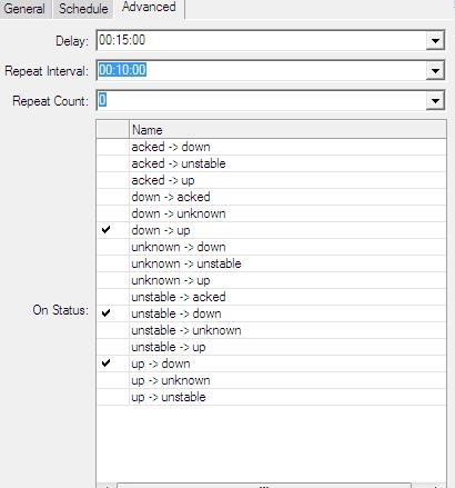

I am using email alerts to alert me when services are down.
Occasionally due to a known scheduled server reboot, the probe would become unavailable. However I ahve a delay on noticifations in case there is some network disturbances etc.
anyway
It seems that as a result of a probe that would go down and up within a matter of minutes (before the delay), I recieve no down notification but instead an up notification.
I have attatched a screenshot of my notification settings.
Would anyone know of a solution to this?

you are missing some additonal checks in that screenshot. devices never go up->down and down->up, they always have unstable in between. make sure you mark those as well.
unstable means that some services are up, and some not. probably - never all your services will become available at the same time.
I do have the notifications set to notify when going from unstable to down and always have, but, what seems to happen is normally the device icon will turn orange when some polls are missed, but in this case mine goes to ACKED automatically when there is a timeout on a service without me ACKing it. Then the service comes back up and I get a message saying the device probe is UP, but no down message, I get the up message because I have selected ACKED>UP in the notifications.
Now I have seen this happen it seems to indicate that this is the problem, for some reason the device is automatically going to an ACKED state when a timeout happens on a service. I have opened the device properties and clicked the Unack button and now it is showing orange correctly.

I only want to get an message if the device is down!
Is this possible?
If you only want down notifications normally you would just tick the unstable>down and up>down options in the list of notifications.
