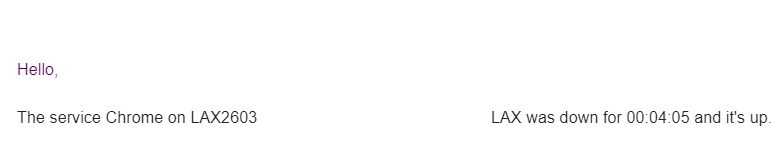

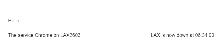

I have a issue with the email notification, i want a notification send 30min after the services on a device is down and a notification send directly when it’s up. Today when a service is down a got a mail 30min after but in the 30min the service is up and send a mail
but i don’t want a notification if the service is up in the delay of 30min.
