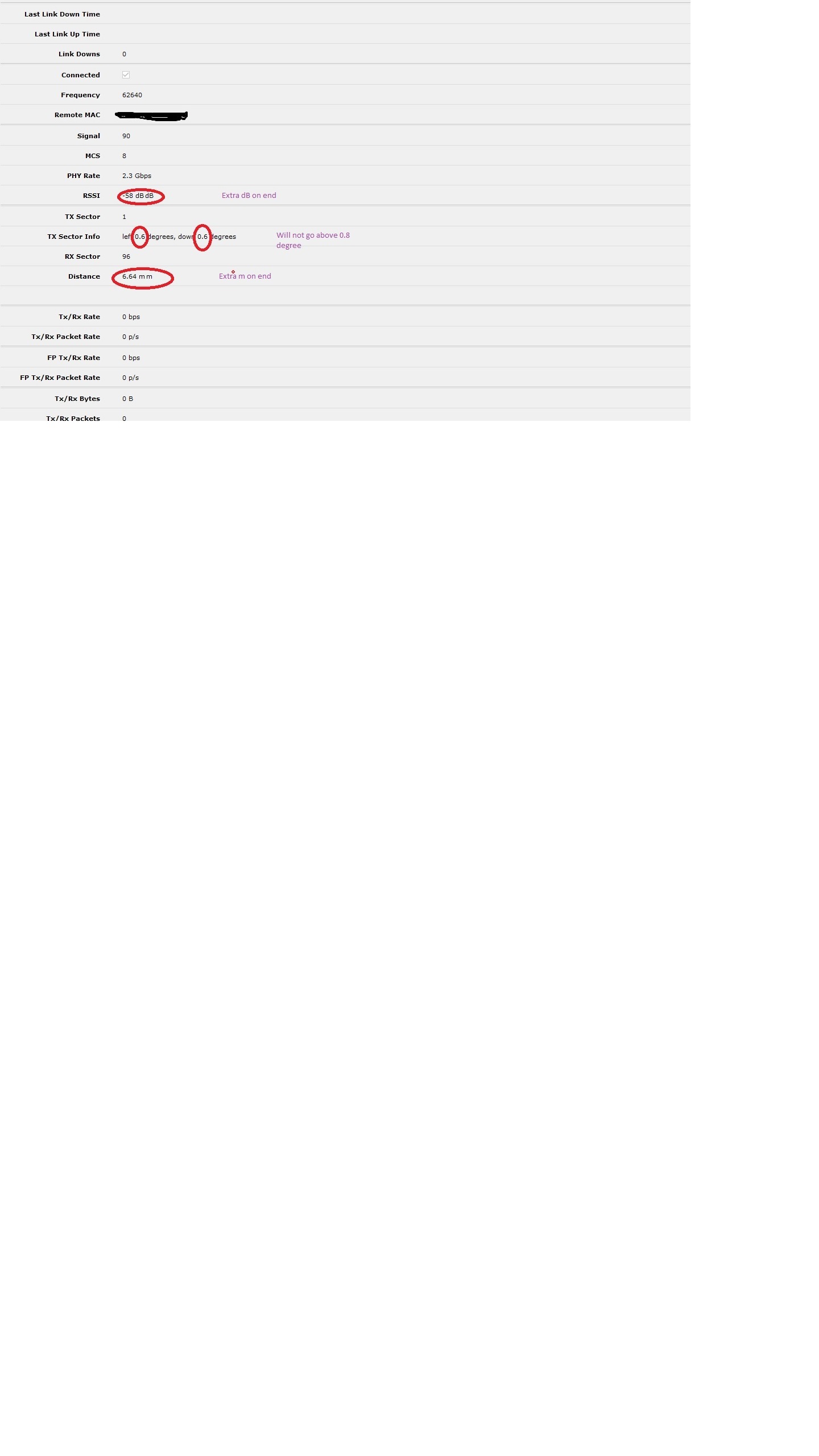

I have an Nray ptp link and i am having problems aligning the unit correctly, the TX sector info will only show 0.2 to 0.8 in any degrees is this correct?
Also the quick set on the master does not change the ip address, there is extra db on RSSI and an extra m on Distance
Has anyone else seen these problems
Regards
Paul
2.3G PHY rate and no link downs? Sounds fairly stable to me. Do you have an actual connectivity problem? How does the same view look in Winbox, rather than via the web interface?

When i turn the antenna to the right the reading will only read 0.2 0.4 0.6 0.8 then back to 0.2, this means you havent got a clue how far you are out in degree’s

The winbox is reading the same as the web browser, reading 0.2-0.8 then back to 0.2 on the TX sector info.

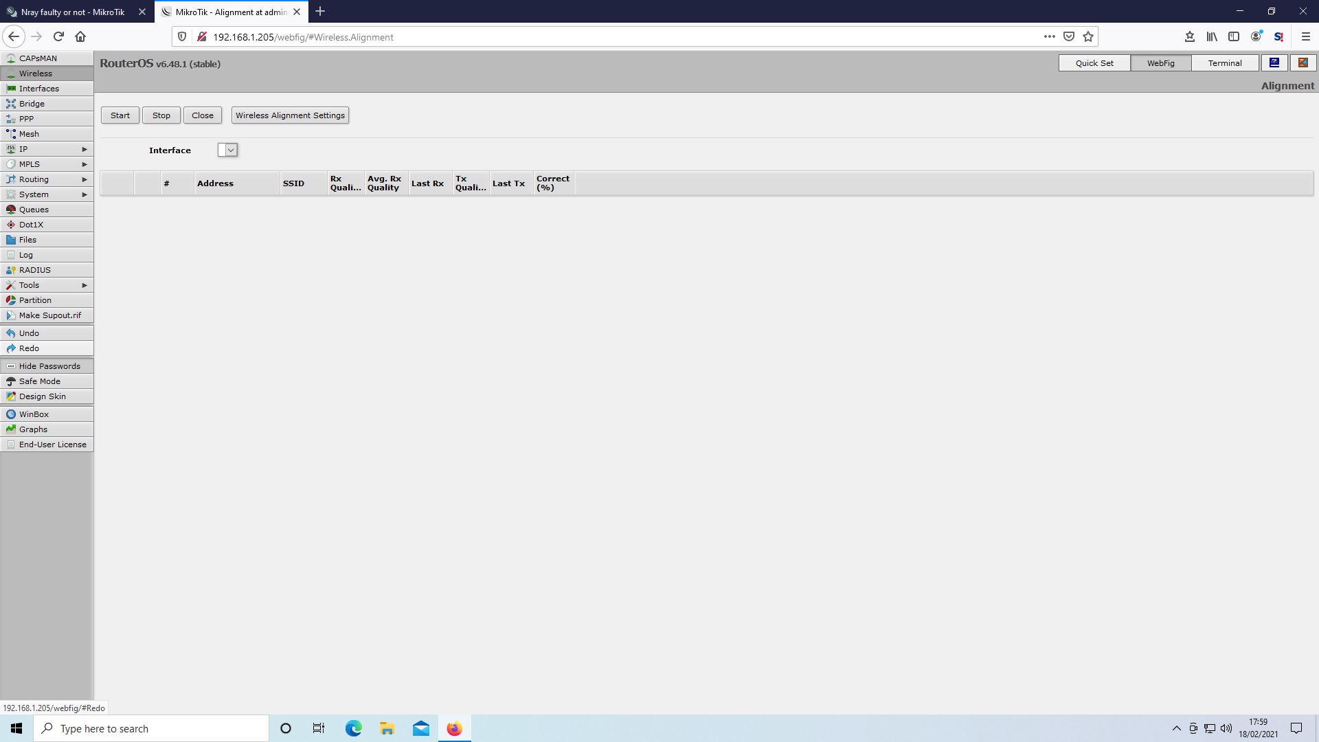

Also the alignment interface shows unknown device when i try to use it.

I gave up with the automatic alignment, once i got a stable connection open terminal and send /in w60g set 0 tx-sector=31 to the unit you are about to move.
Align the signal to best point signal (take your time) , send same command to the other AP and align that.
Send /in w60g set 0 tx-sector=auto
now i have a better stable connection i the fog.
I hope it might help someone
Could any one who has an Nray, tell me if the wireless alignment works on the GUI or only on the terminal command line?
